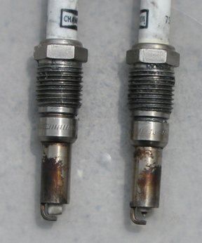

I installed Champions last night on my '05 vert. The stock plugs all came out very easily, with the exception of the second plug from the front on the passenger side. It took a little extra to get the plug to break free. I followed the TSB to the letter. The motorcraft carb cleaner liquifies the carbon buildup on the plugs.
My car only has 6,500 miles, yet it still had some carbon buildup on the plugs.
I notice no difference yet with the Champion plugs. Hopefully, they will perform well. I did go ahead and put the nickel anti-sieze on the barrel of the plugs, although I don't know if it will be needed since they are one piece.
It appears that it may be driven mostly for short distances if it's an '05 and has only 6500 miles. If that's the case, then it's possible that most of the time the engine is running rich and at high idle, and it's not running for at least 20 minutes at normal operating temperature. And that will cause the plugs(as well as the combustion chamber) to quickly become carbon fouled.
I would assume you are correct on the car being driven short distances. The previous owner is from a small town, and it's pretty obvious from the mileage that he didn't take a lot of road trips.
And I drove the car about twenty miles last night, and now that I have I'm convinced that the Champions perform a little better than the original plugs. Very smooth, seems the throttle response is better.
