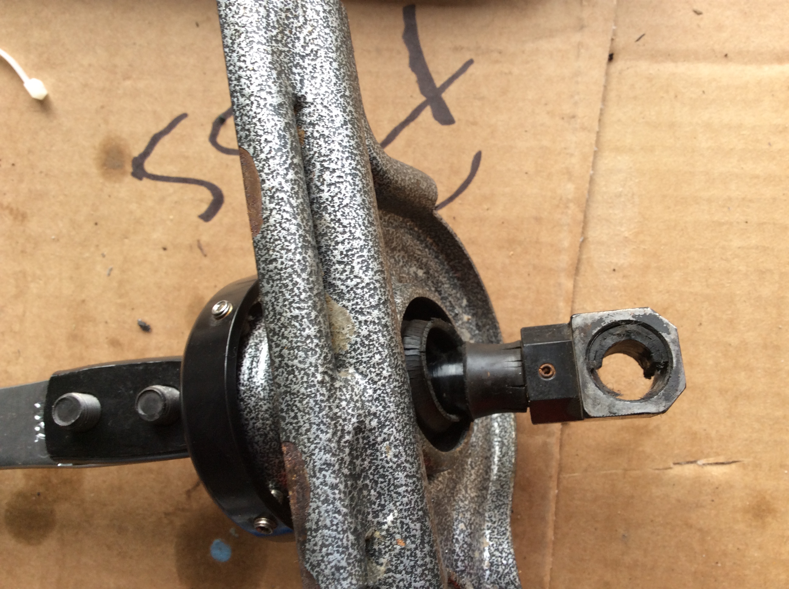

Mine was clicking as well, I found the handle screws had come lose, and the bushing had broken off at the linkage. Note pic. Get a MGW and don't look back.

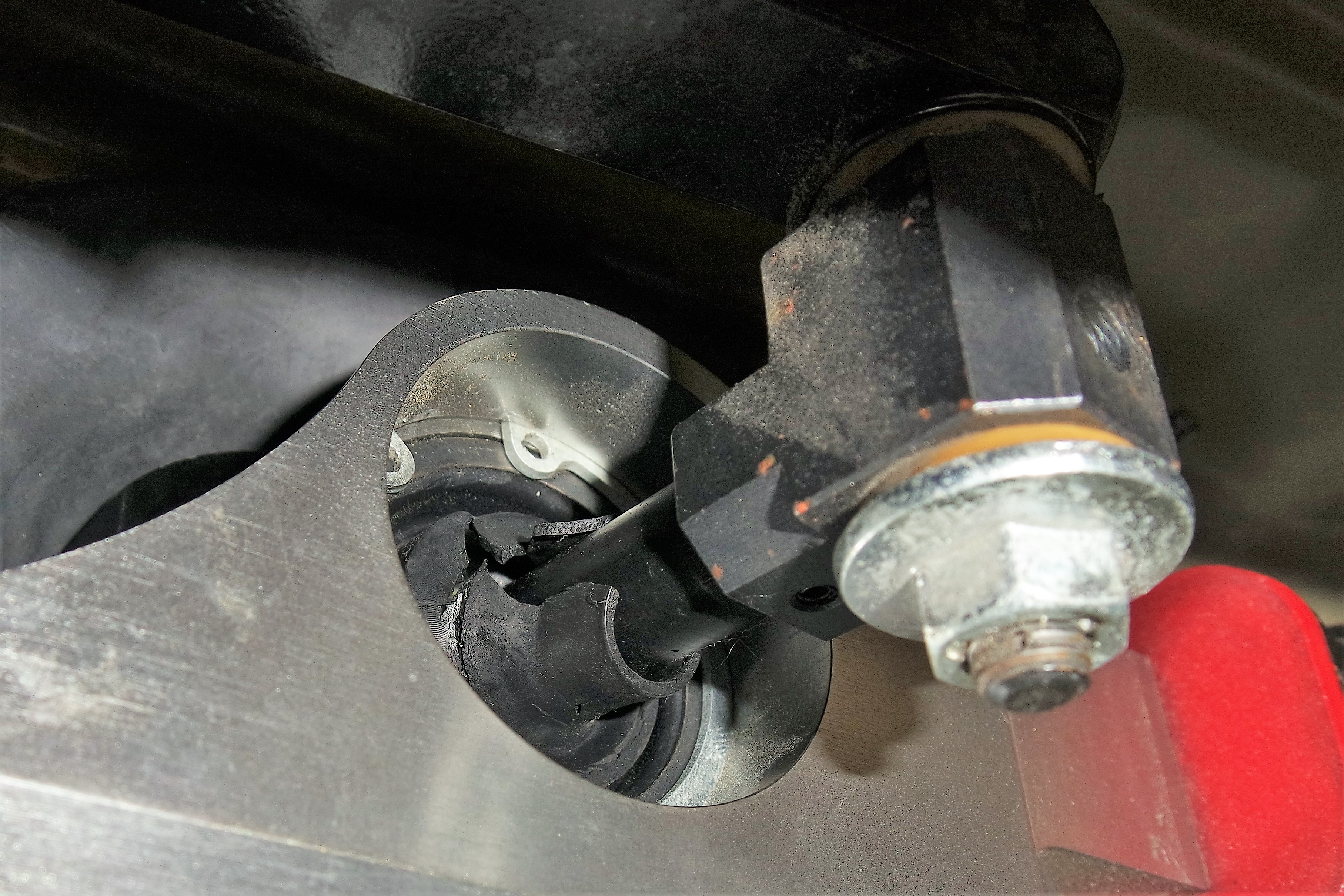

Looks like the bushing on the bottom of my Hurst cracked apart. Is that what is causing the clunking?

If you zoom in on my second pic, you can see the boot is deteriorating almost completely. I can't believe Shelby and FRPP even sourced out the regular Hurst for the Shelby GT.

I pulled the Hurst Billet shifter and the center joint is pretty much done. There's zero resistance and it just spins. I think it uses that bottom boot for spring action or to dampen any vibrations. That boot is slowly falling apart. I replaced it with a MGW.

The rubber boot underneath the shifter (the one facing the driveshaft) tore on mine causing a lot of slop and the clicking. Hurst relies on that for the cushioning and denied replacement under warranty because I bought my shifter a month before they started the lifetime replacement. The MGW was significantly better.
