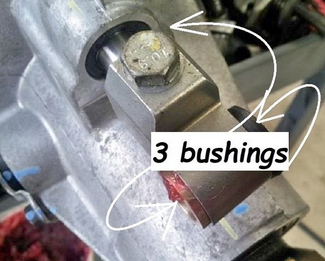

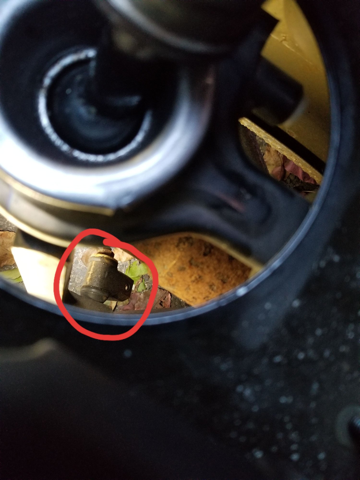

I had this problem with my stock shift last fall. Stock shifters normally have a little play in them but what happened with mine was the bolt that attaches the shifter to the top of the trans came loose the the shifter just fell off. It might have to be tightened up and have some orange lock tight on it try not to use red for its a lot more difficult to get off if it has to be taken off for some reason. This is what the block looks like that the bolt is through. If you get under the car and reach up on top of the trans you will feel it.

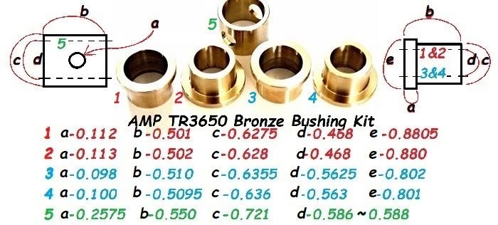

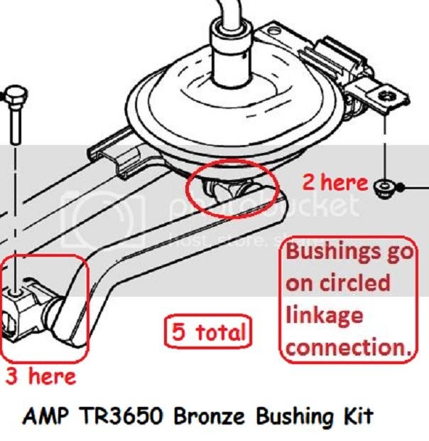

The shifters do not change the OEM bushings for the link nor the attachment point on the shift rail or shaft up on top of the transmission. Any "play" that existed in the linkage bushings from the stock shifter to transmission shift shaft when stock will still be there with an aftermarket Hurst or other shifter. The shorter "throw" length comes at a cost of increased effort. There are bushing kits available to tighten the play up, I have one but just haven't installed it yet. Plastic gets replaced by brass. It holds great promise. I did have some verticle play in my shifter, a Hust billet ... maybe 1/32" ... but that was not the source of any shift quality issues. I did apply grease to that ball fulcrum to dampen any noise transmission up the stick to the ball though.

Yes that's what I was thinking. Does anyone know what that block is called where it says three here on the picture, that's where mine came apart and when I do eventually get a shifter I want to replace that bolt that's in there. Dont trust the one in it any more than the one that fell out.

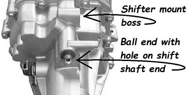

I too have looked online for that bolt with shaft on it. I don't hammer the shifter, but when I put these bushings in, I'd like to have a bolt "on hand"
It goes through a "block" and bushing with a hole and locks it on the ball end of the shift shaft, it has to be able to wiggle left - right but the pin part rotates the shifter in your hand with the shift shaft on the transmission top. The shifters have no "gates", any gates felt are inside the transmission.
I figure anything else screws up, I can make or fix. But I'd like to have that bolt.

Yeah I know what you mean, that bolt fell out on me when I was in fourth gear one day had to drive it home in 4th for about 3 miles. I got a grade 8 bolt from a local steel and metal place that worked but it went through the hole not screwed into it. Also put a lock nut on it with some loctite. Hopefully it stays together.

Well I believe the block is called the shoulder no real specific name for the bolt but pin bolt. Was doing some research and found this.
