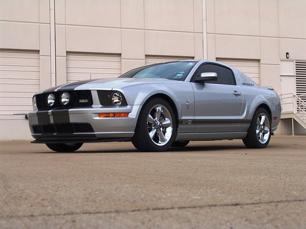

Here is a shot of mine with the ultralights.
Tim

Looks like an eibach pro drop. I can't really see much of a change when I see people with the Ultralites. From a exterior mod, it doesn't do much for the car (at least for me); from a handling, I hear it does well.
I read in you sig. that you have pros as well... so the pros go lower than the ultra lites right?
Also do you think that with FRPP K's will go lower than pros? Is the ride quality going to be good with pros and KONI Dampners?
