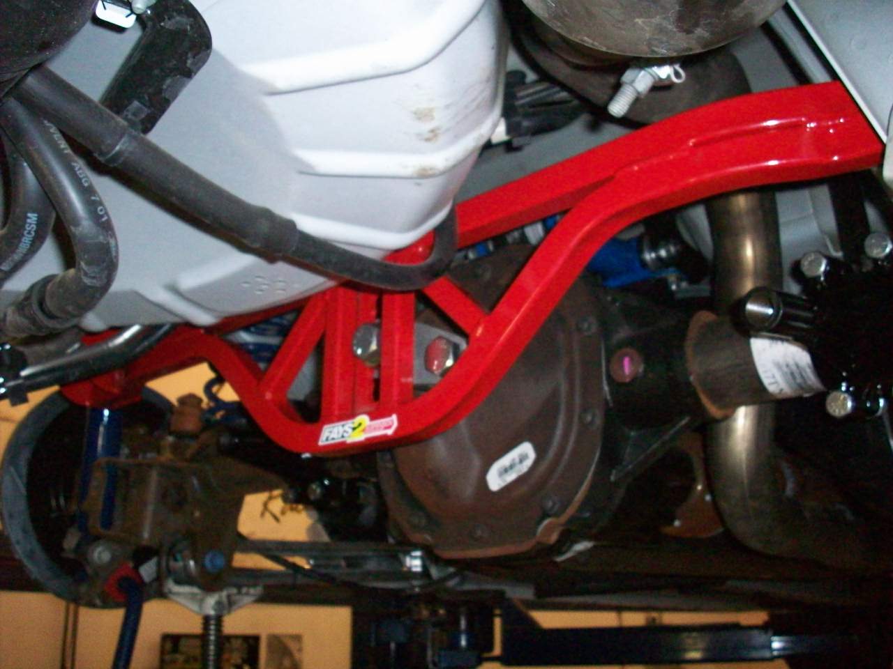

Here's a pic installed.

For whatever reason your pic is not showing for me and I need to see this installed. I've been completely unaware of this part.

Here's the pic....

Does this replace the panhard bar? I don't see one in the installed pic.
