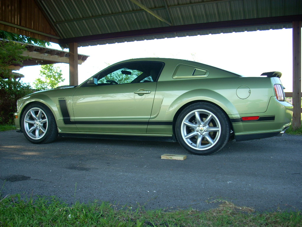

I drove to Hewitt Tx on Sat and picked up an set of FRPP M5300K along with the GT500 upper spring mounts. man it rides good. I do think you need a set of camber bolts.

Attached Thumbnails eibach kit cheapest and best way to go-car-springs-007.jpg
