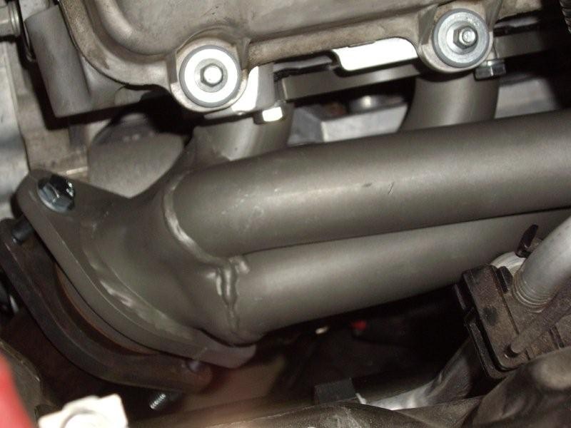

Old Sep 29, 2007 | 06:43 PM
GRAYPNY's Avatar
Joined: December 12, 2004
Posts: 5,801
From: NorCal
Not if you go with shorty headers!
Attached Thumbnails driveshaft vs. headers-jba-shorty.jpg   driveshaft vs. headers-collector.jpg
