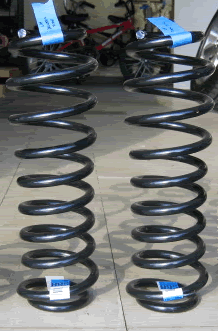

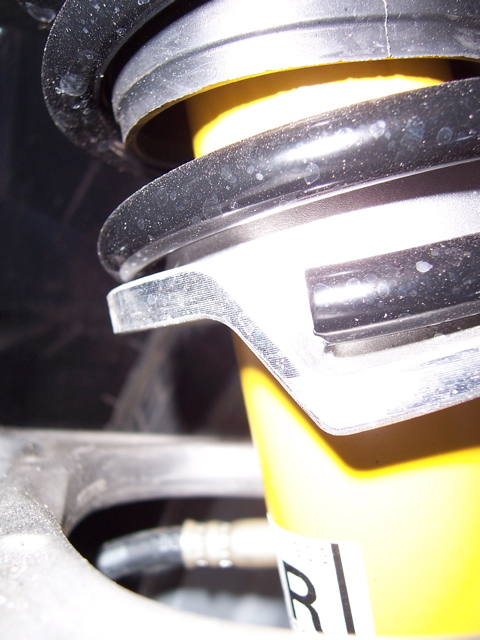

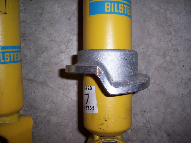

Thought I would throw these in. While not a Mustang, you can see how an open coil is supported and located by it's proper matching perch.
Since the first coil rests on the perch it would not be used in calculating spring rate.

There you go, a picture is worth a 1000 words.
