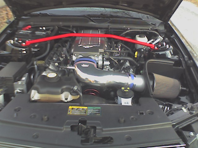

Talk to brenseed but unless your going to add cams or something the street will be all you need! heres a pic of my C&L CAI from brenspeed!.........Great choice!
