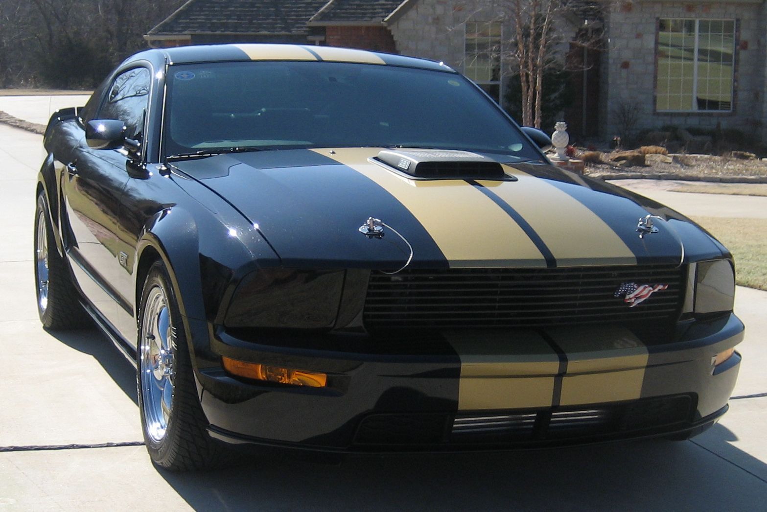

After 3 years of saving, shopping, spending and modding, I finall have my hot about where I want it. You notice I said about, which leaves the door open for more in the future. Most of the recent work was done at Bolt-on Performance in Moore OK and the owner Glenn Moore likes to call this the BOP Super Rod. Glenn is a great guy and if you are in the OKC area and you want a great mod shop, go see him.
I have been working on this car for 3 years so have a long list of mods including MAC LT headers, Hurst shifter, Bassani exhaust, Shaker scoop, ducktail spoiler, Agent 47 mirrors, CDC grille and Steeda sport springs just to mention a few.

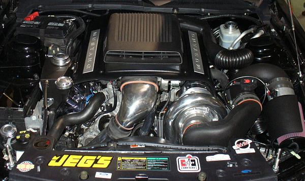

My latest mods include a Paxton HO SC. We were able to mod the shaker to keep it functional. Flex hose dumps air right on the Paxton filter. This things rips. Now I need to relearn how to drive it.
We also added an Alum SpyderShaft, BMR panhard bar and drive shaft loop and a CHE upper control link. Already had Metco billet LCAs.

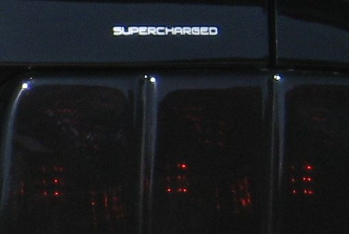

The only indication it has a blower is a small "Supercharged" badge above the right rear taillight.

Tell me what you think.

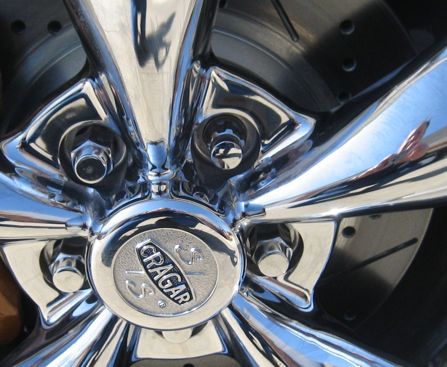

Man, your car is looking good!! One question. Are you running the stock FORD bullitts?? If so, how did you get the crager center caps to fit?

I had to use my Dramel tool and rework the inside of the Cragar cap. Used the original snap ring and disc after I popped off the cobra thingy on the front. Drilled a hole thru the original disc. Placed a long bolt thru it and into the Cragar center cap. Added some lock tight, snapped the ring and disc into the wheel center hole and hand tightened the center cap. If you tighten it too tight, it will popp the ring out. Get a Cragar cap and you will see it is not that difficult.
Thanks! Will try one of these days!!

Let me know and I will walk you thru it.
