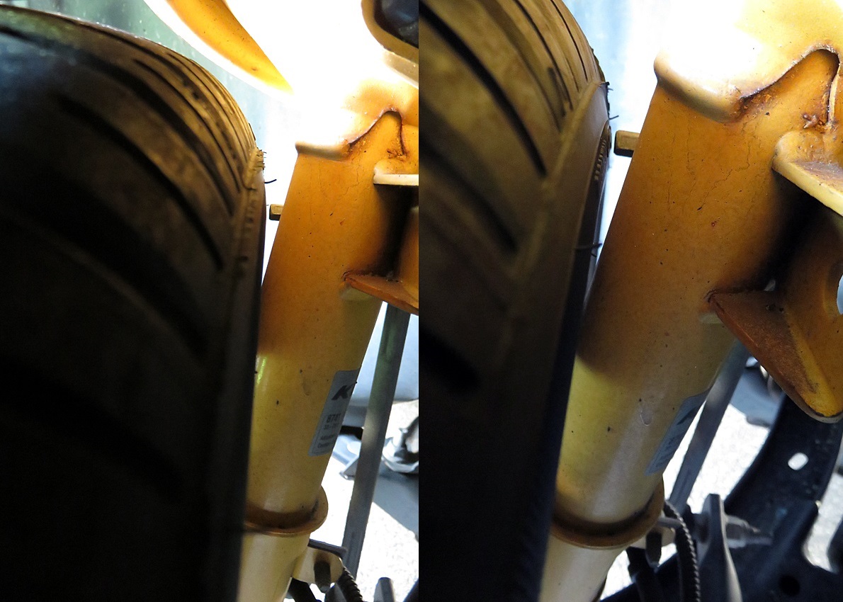

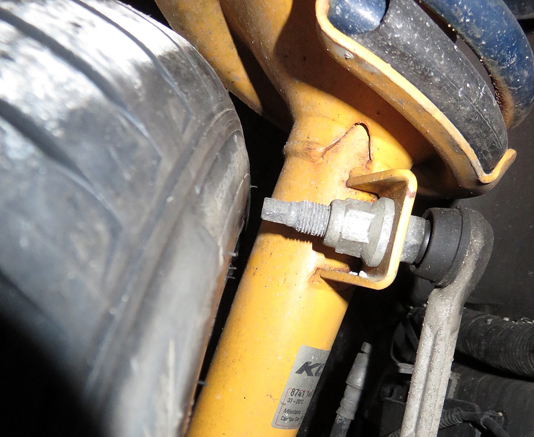

So Gabe, how much to they clear those struts and endlinks by?
About a 1/4"

Looks like some hard cornering and tire flex will have that tire cut on the bolt there.
Shouldn't be an issue. The tire has no reason to flex up there, there's nothing pushing it, unlike at the contact patch where the friction with the pavement pushes it to one side or the other during cornering
I autocrossed the car with the set-up below with no issues
(285/40/18 Goodyear Eagle tires on SVT 18x9.5 wheels)

Wow that seems to close for comfort?

We've told him that before. But hey, he lives dangerously. The name's Gabe, shaken not stirred

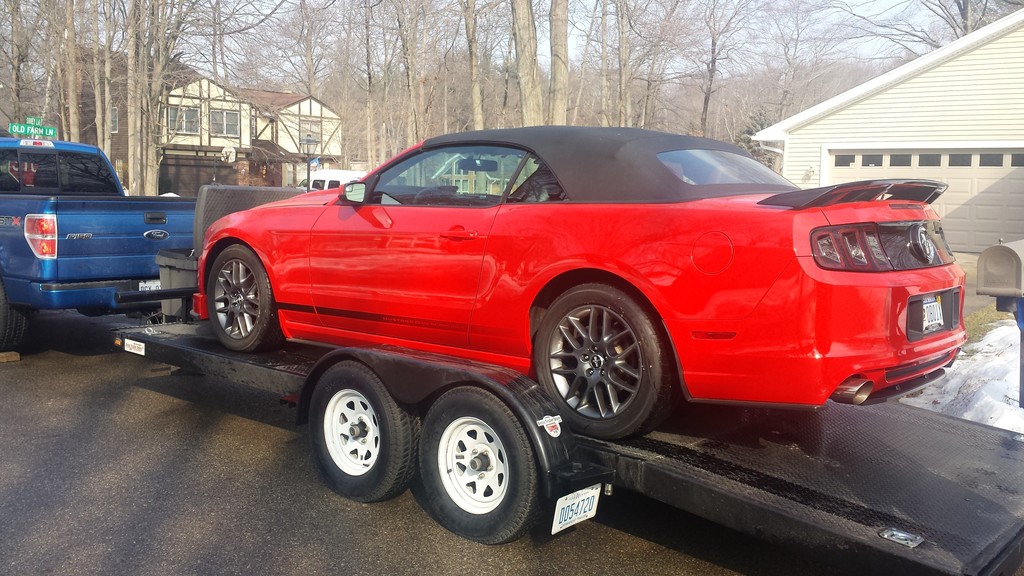

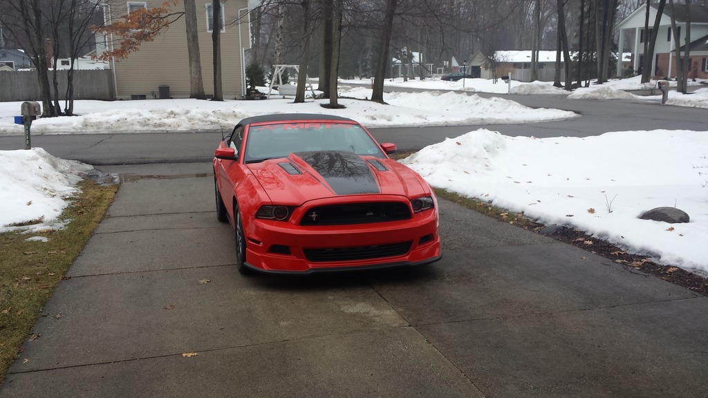

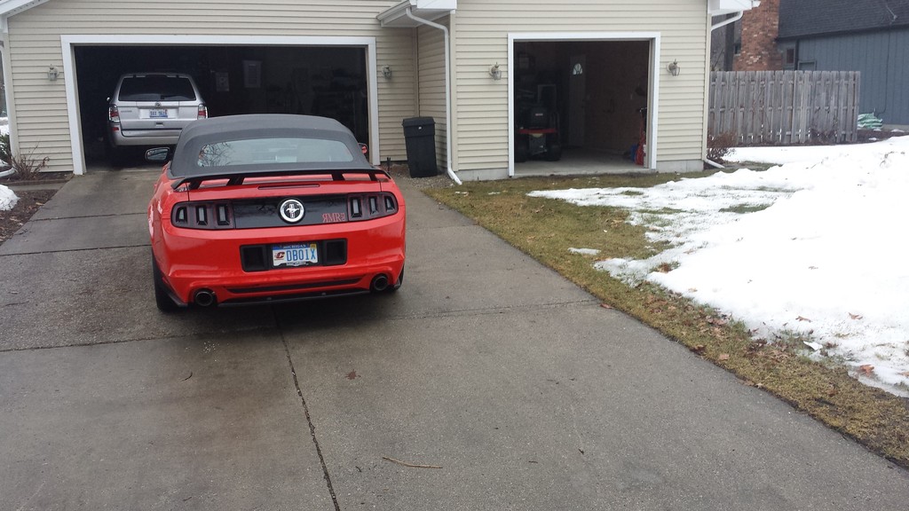

I got mine out of the garage finally - had to clear over a foot of snow first. Then loaded it on the trailer to take it to MRT in Plymouth, MI. Replacing the engine, took out 2 piston ring lands (one on each bank) on the first WOT test last year with the turbo. So new engine and start tuning all over again, with a different tuner this time.

Lol Burton ... you saw my previous 285-wide front set-up and how close THEY were to that stud and the strut body, and it had NO rubbing ...

You're a brave man. I'd be worried that some way, some how, they'd somehow twist and flex and make contact. However unlikely that is, especially if you've done AutoX with a similar setup.
But if you want a little more clearance, I don't see why you can't grind down that endlink stud a little bit. It looks like you have the newer style of endlink with the hex holding flange built into the stud near the socket (so no worries about having to use a holding wrench on the end of the stud.

I still might do that, but just wanted to say that I've already had less clearance with no issues.
