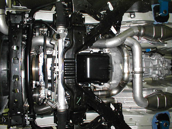

Everything is up front where it's supposed to be. I actually don't know how it could be any shorter. Where did you get that it had to run to the rear by the axle-backs, Bill?
Here's a pic of the plumbing from underneath. There are no clearance issues since everything is as high or higher than the stock components.
Attachment 34551 The H-Pipe is cut and the cats are changed out. So everything is from the cats forward.
Keep giving me negatives... anything that comes up I'll ask them before ordering!

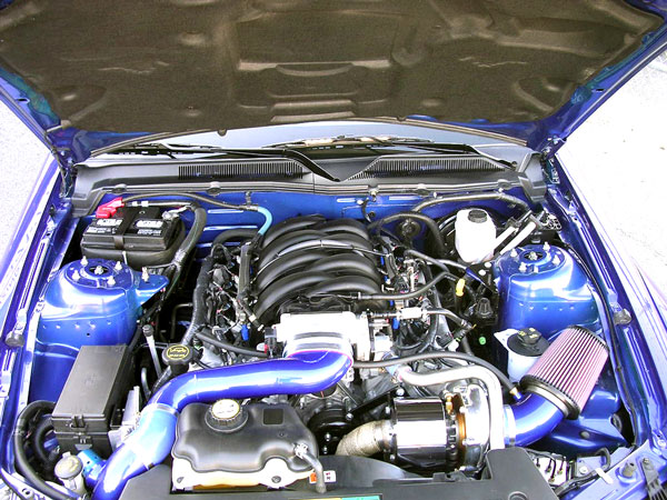

Attachment 34554 All the Ace bandaging is under the car. I think it looks great! I would have a custom stainless fuse box cover made up with the car's RWHP and TQ.

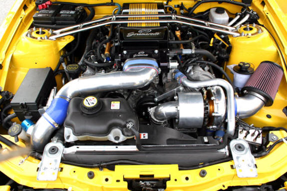

Attachment 34555 I realize this picture is a little different. I'll find out if this is an old or new kit. Maybe the kit now includes the stainless bend shown in the yellow car's kit. If this is the way it looks, I'm ok with that little bit of heat shielding showing.
On Granetelli's 200k mile claim, how do they know this? Is this how many miles is on their test mule? What I predict after that many miles and boost are worn out piston rings and valve guides.
