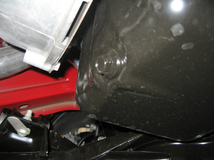

Mine are the same as yours Leo. Attachment 34452
It's a flag bolt, so you'll probably need an offset open end wrench to start loosening the nut (doesn't look like there's enough room to slip the box end wrench over the bolt shank; too close to the body), then can switch over to a ratcheting offset once there's enough room.
As far as torqueing it down, you may need an offset crowsfoot with wierd extensions just you have the room to manuever the tq wrench around. Or, just resort to the calibrated elbow method.

Torqueing shouldn't be a problem as I'd reinstall them the opposite way. Depending on if I have time or not I'll give it another shot tonight. I'll let you guys know how it goes.

Might not be able to do that Leo. May not be enough clearance to drop the bolt down from the top. Unless of course you drop the support down.
If I get mine tonight or tomorrow, I'll attempt the install and let you know what I did.
