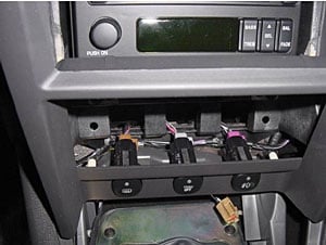

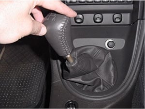

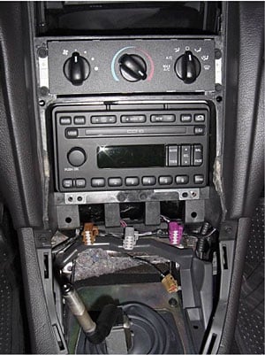

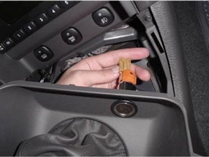

I didn't write these instructions I just found them on another site. But it should help you remove your radio
0) Unlock both doors, then use the 8mm socket to disconnect positive AND negative battery cable.
1) Remove the shifter ****. Place the shifter in 2nd, 4th or Reverse (for clearance)
2) Remove the shifter shroud by pulling out, towards you.
3) Disconnect the accessory plug harness.
4) Place the shifter in 2nd, 4th or reverse (for clearance)
5) Remove the radio/AC/vent trim panel by pulling towards you
5a) Don’t forget to unplug the connectors from the backside of this panel before removing!
5b) Start from the bottom and work your way up. Panel clips hold in that panel. Be gentle, don’t yank.
6) Remove head unit by removing the 2 outer bolts with the 7mm socket. Set bolts aside.
7) Disconnect the 2 wiring harnesses and antennae from the head unit. NOTE: Antennae simply pulls straight out.
