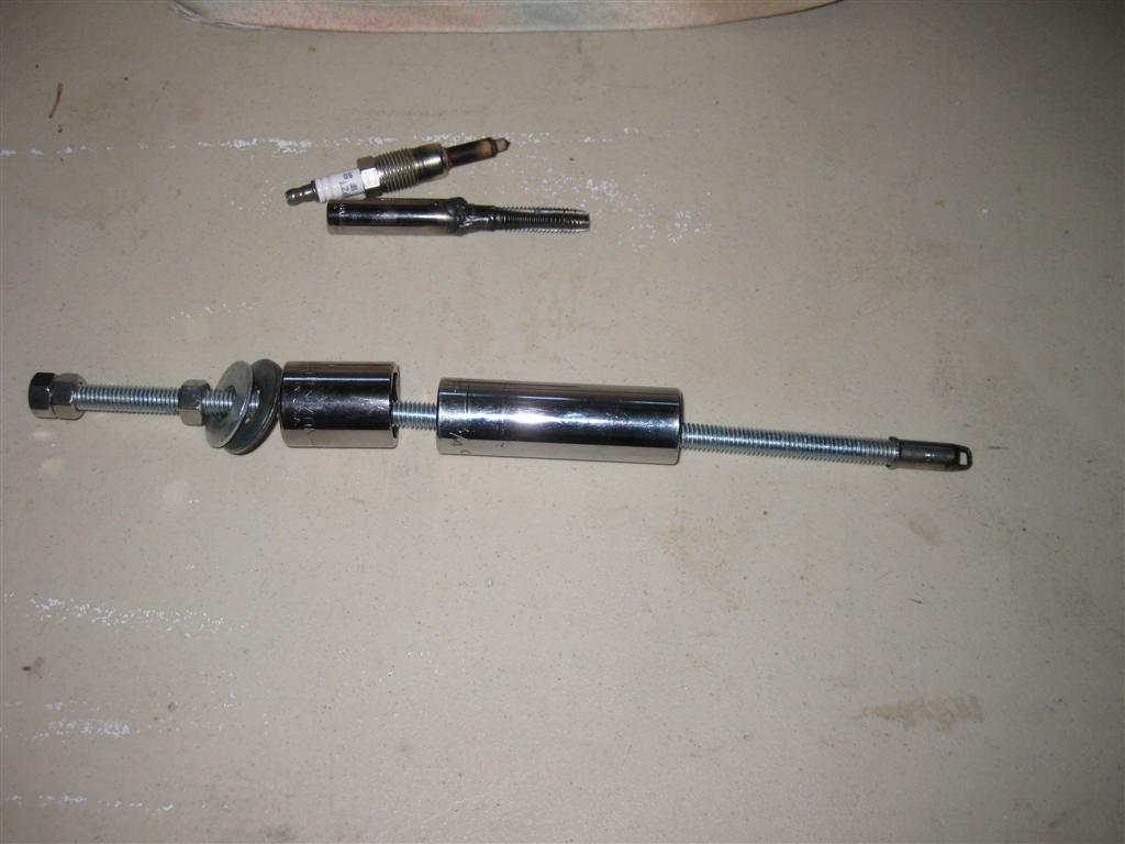

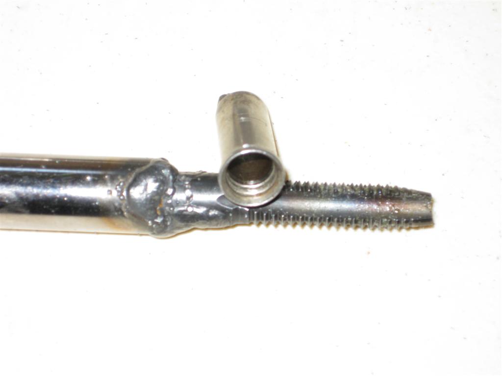

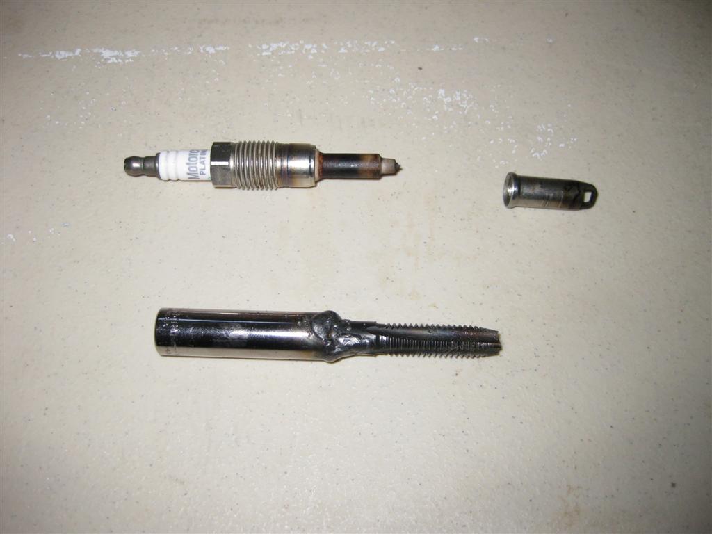

I made my own tool as well, but I used a 3/8 tap, and 3/8 threaded rod!! total cost.... less than 5 bucks

gotta love homestyle machinists!

I used an oil soaked Q-Tip at the bottom, and lots of axel grease on the tip of the tap to prevent any shaving going down there. Also I just cut about 3-4 rotations in mine, then that metal sleeve started to turn in the head, so I figured I had gone far enough, sure enough, it came right out with no problem!
