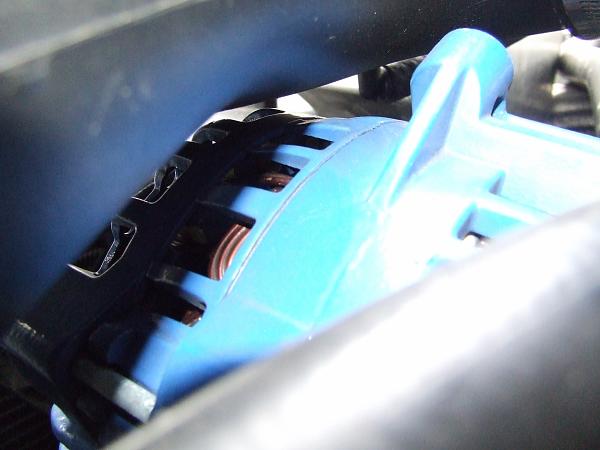

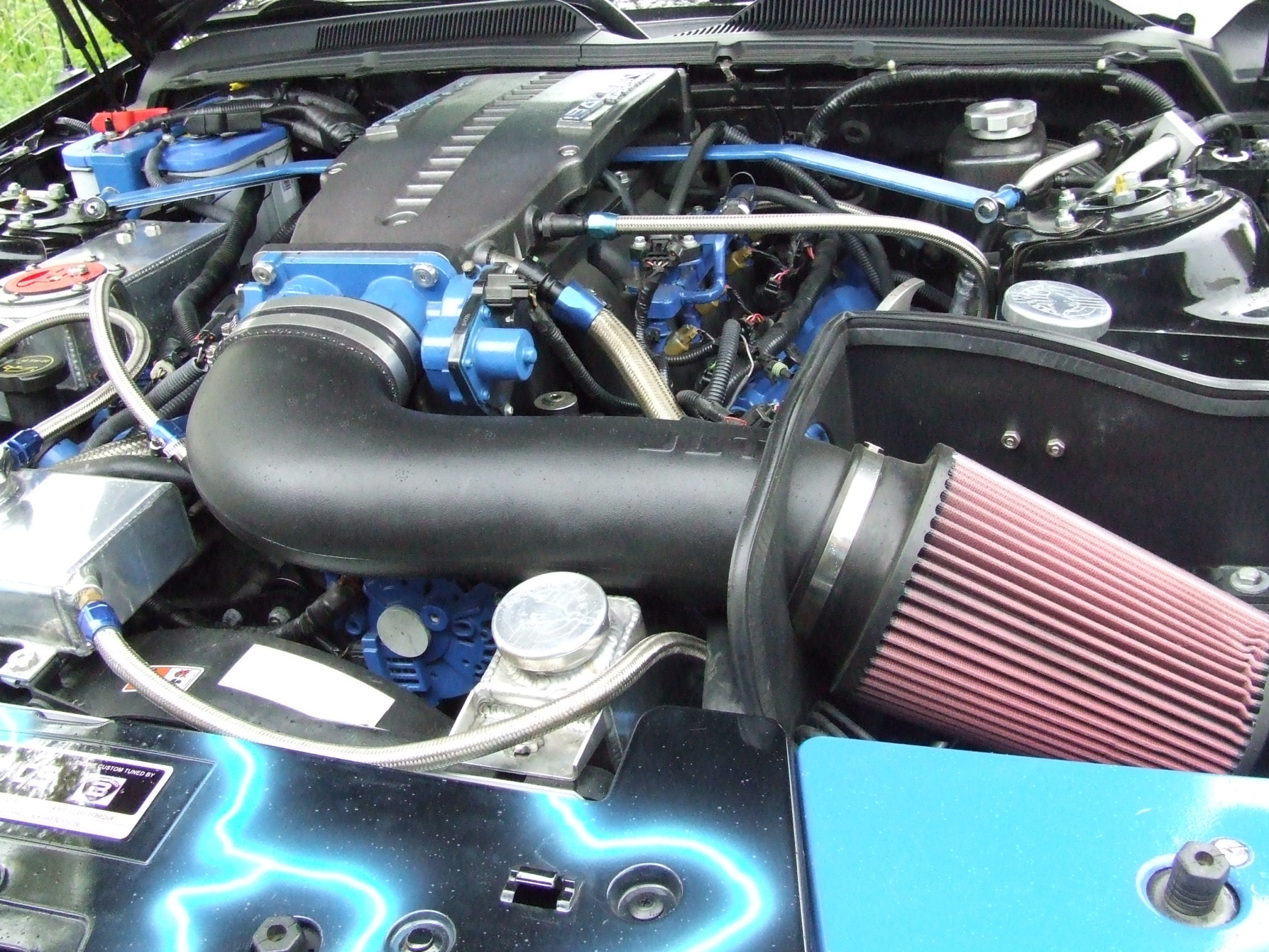

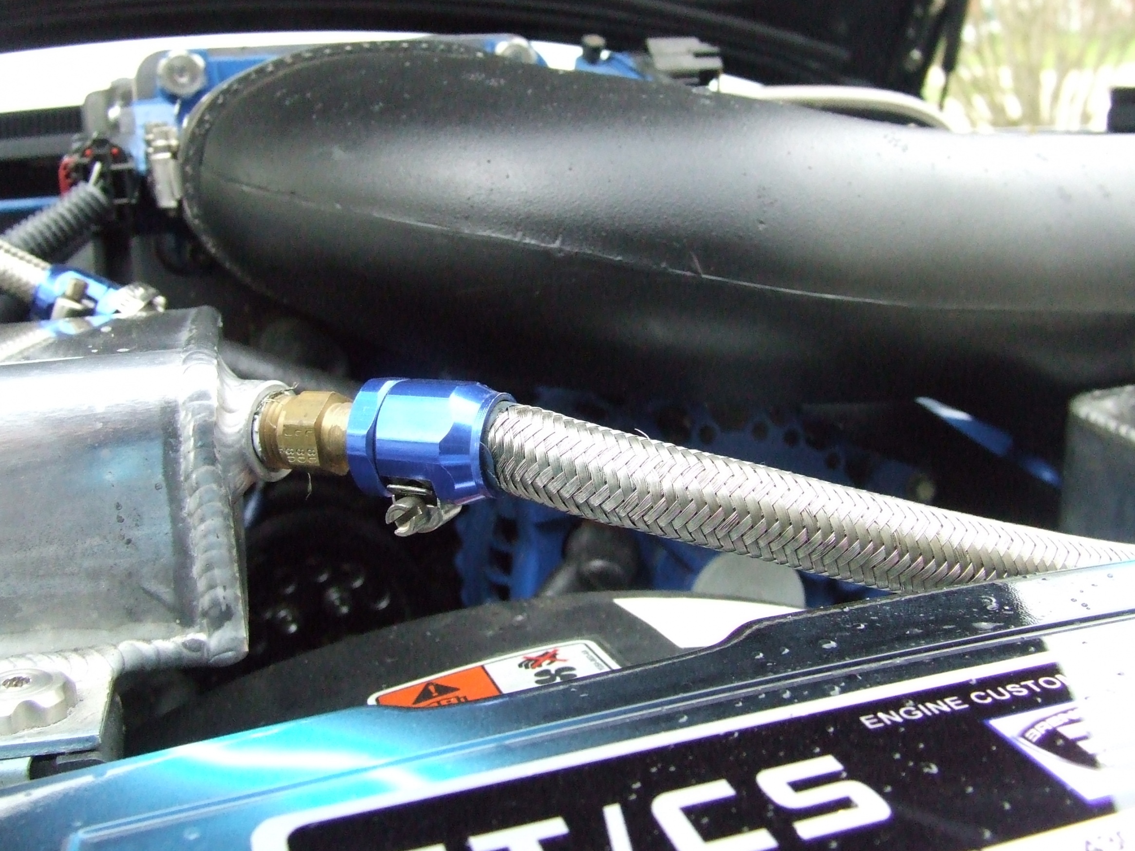

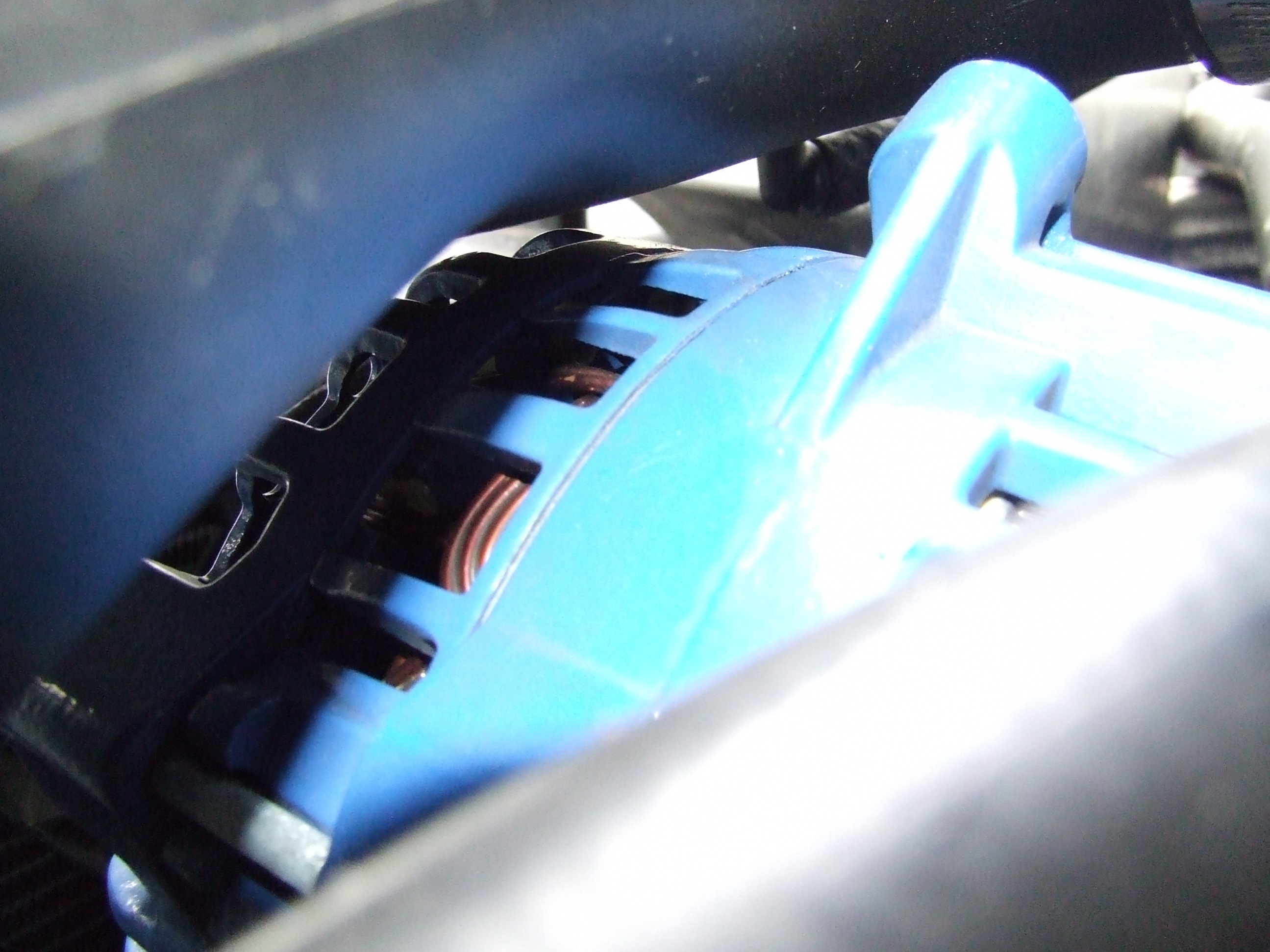

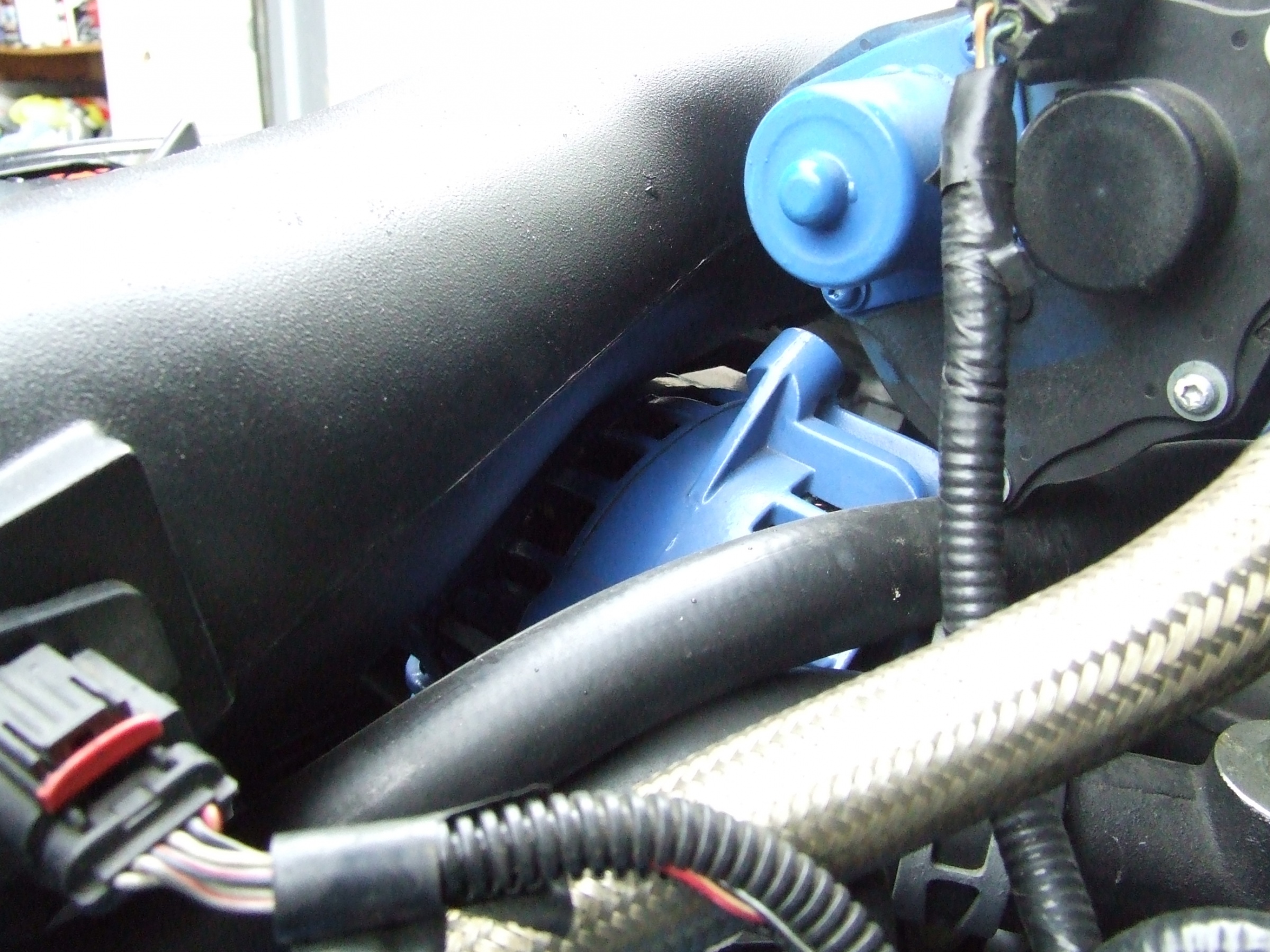

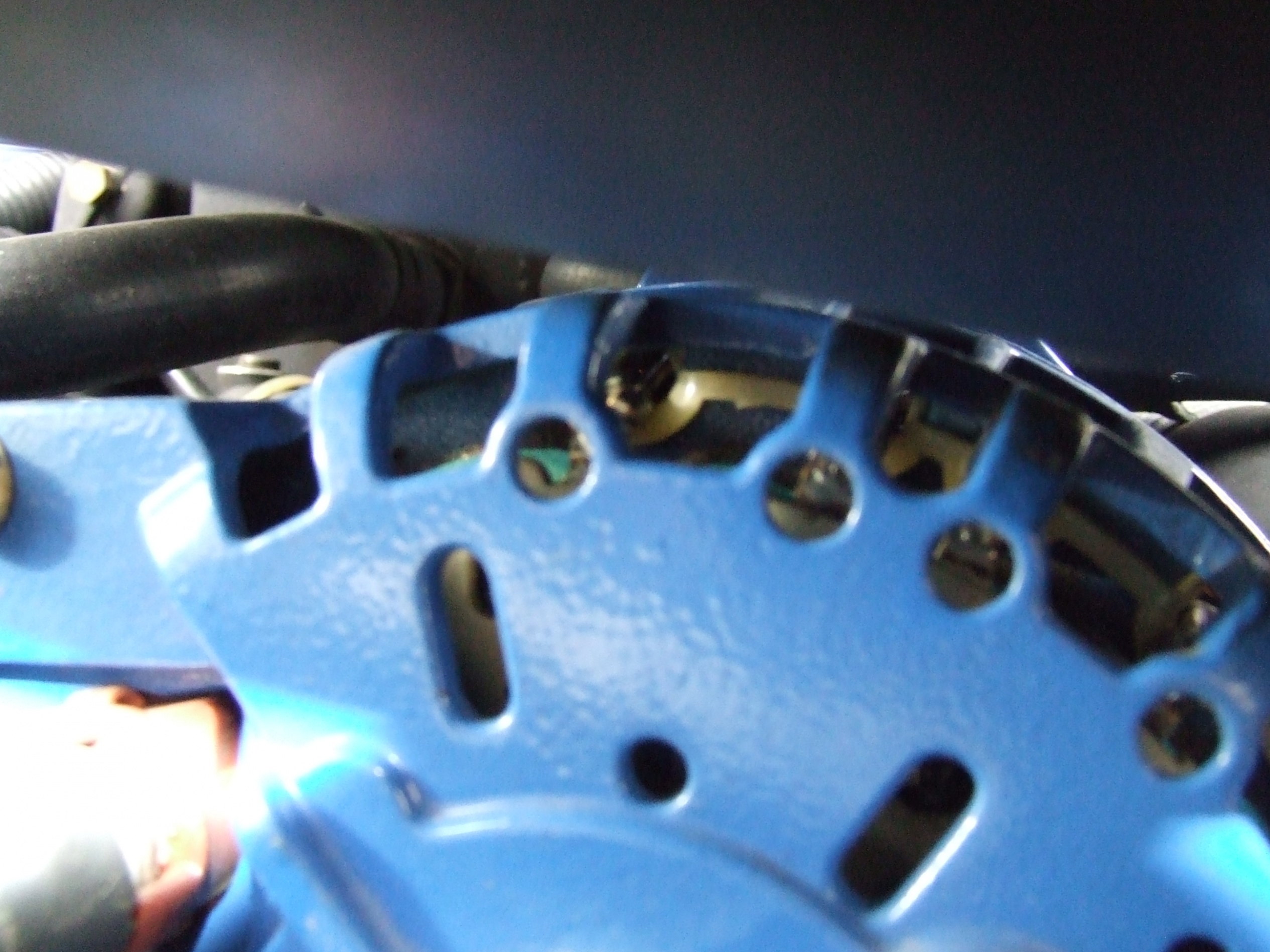

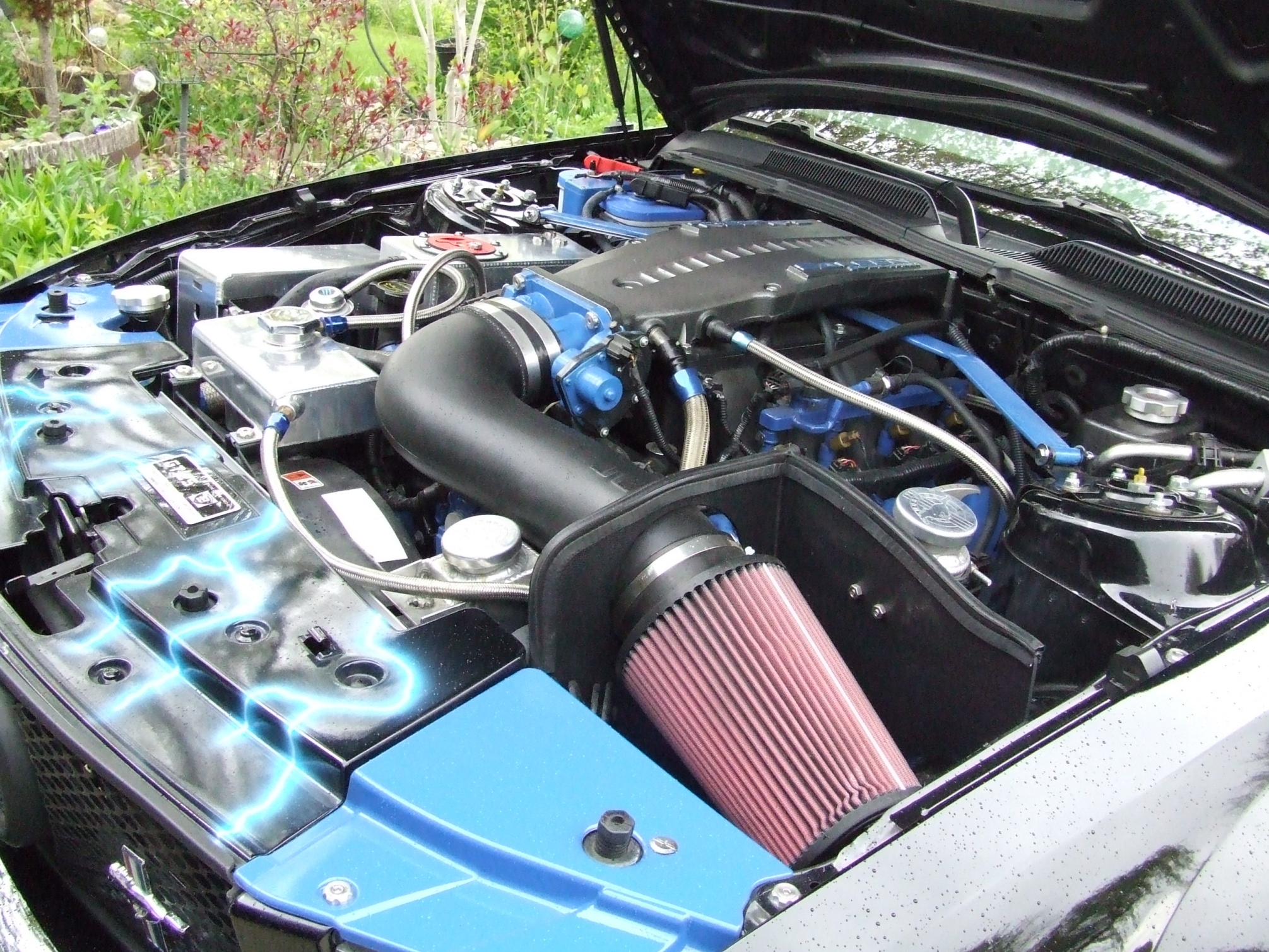

Here are the pictures that m05fastbackgt wanted.

Thanks for the pics ! Are you still using your PA alternator and if you are.. Is it smaller in size over the OEM unit ?
