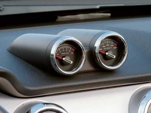

Man, I didn't really keep up on this thread on this board. Short version is been driving the car since getting the dent repaired over the summer. It's got a wierd problem where on cold start it revs up to 3000 RPM for 10 sec and then all of a sudden the revs drop and it almost stalls (or actually does flood). The shop's been trying to figure that one out, so in the meantime I've been ready to roll out as soon as I start the car so I can get the RPMs down.
I just put the deposit down on parts today, so parts have been ordered! Been doing a lot of back and forth with the shop on the supercharger, mostly on the gauge setup. Here's what we're going with:
Vortech V3 tuner kit
ACT sensor (Lightning) and pigtail
MAF flange
Mafia controller
650cc injectors
Oil pressure gauge https://www.autometer.com/2-1-16-oil...port-comp.html
water temperature gauge https://www.autometer.com/2-1-16-wa...-warn-100-260-f-stepper-motor-sport-comp.html
AFR gauge https://www.autometer.com/2-1-16-wid...port-comp.html
Saleen dual guage pod (dash)
Autometer single pod on the corner of the A-pillar
The autometer pod is this one: https://stmtuned.com/products/2121-...OufWn3drXHONFDslKw_-kuqHbVJyTEHzHvdWo8-c-e0FD
Decided not to do the boost gauge, 4 gauges was kind of overdoing it, it was just for fun, and it saves a few hundred bucks. Will probably do AFR over by the corner of the pillar and the dash, then in the saleen pod prob the oil pressure on the left and water temp on the right. The shop had a good point about the pillar pods, they tend to put the gauges further towards the back of the car, so you have to look away from the road to see them. Just a single gauge down by the corner of pillar w/ the dash will keep it in my field of view when I'm keeping my eyese on the road.
Here's the Saleen gauge:
