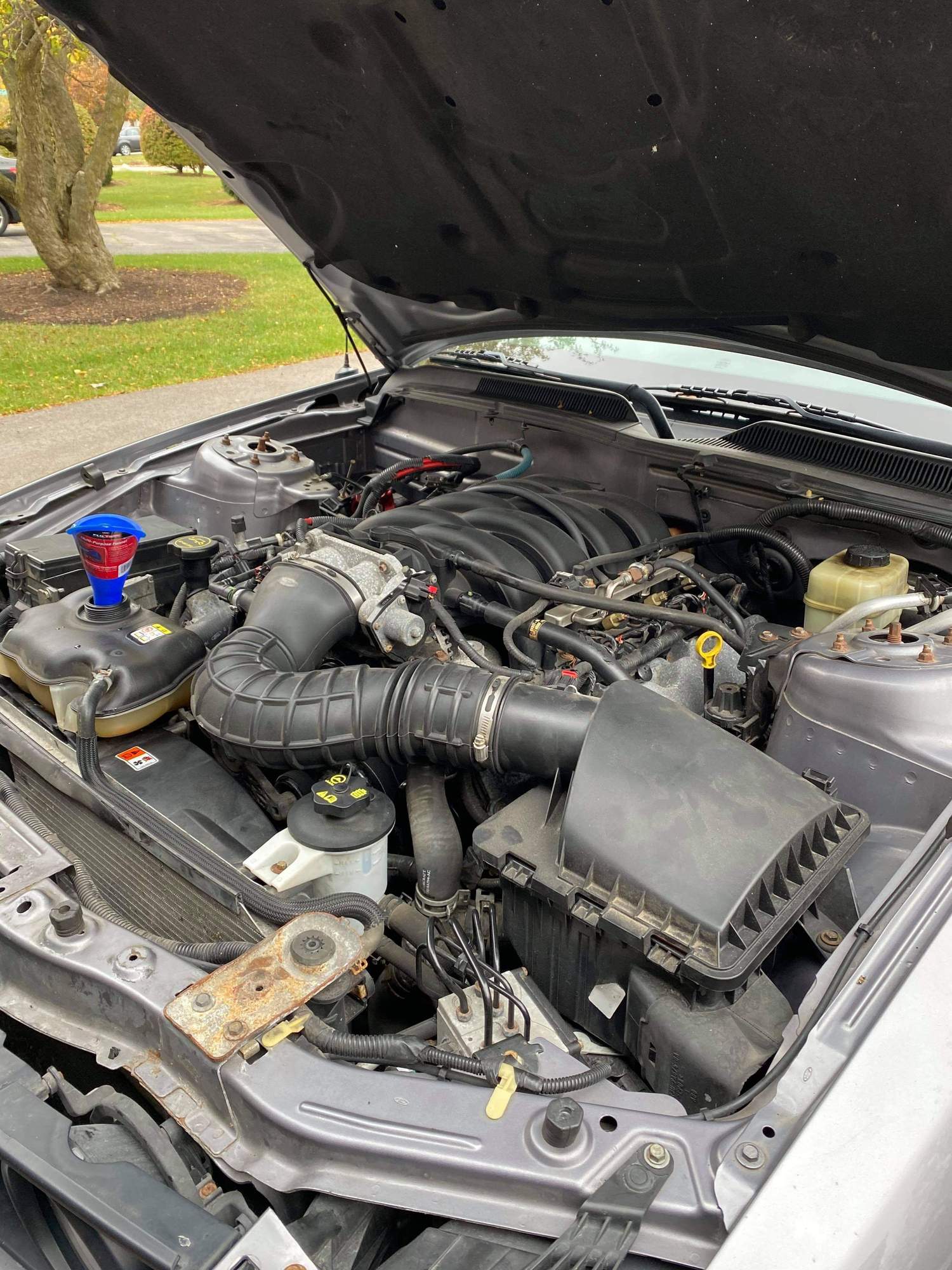

Hello Everyone,
This is my first post as I am a new member. I am going to try and be as detailed as I can be with the specific problem I am having.
So I own a bone stock 2006 4.6L 3v Mustang GT with just over 165,000 miles on it. Last week I was driving home from work and all of a sudden the engine started acting all funny and I get an engine code. Get it home, P0016. I pull the valve covers and sure enough, timing chain skipped a tooth and the passenger side guide broke into a ton of pieces. I went and bought a new timing chain set, some new plugs, and VCT Solenoids.
So when I open the Valve Covers, there was a lot of Sludge in with the Cams and Rocker arms. (A lot to me, overall, it could have been MUCH worse). So I spent a bunch of time picking at it and cleaning up as much as possible without being too abrasive to the cams.
So anyways, I do the repair and take it out on a few test drives. First couple were nice and gentle. The last test drive, I do some hard pulls on it and it feels perfect. Feels like I actually gained some additional power back on the repair.
I wake up in the morning for work. Starts up perfect. Put it in reverse, still fine. I drive forward probably about 300 yards to the stop sign,, and as im braking, the car starts this aggressive shudder. Like I figured something internally was grinding. definite oh **** moment. Even the lights start to flicker. I make it back home and pull the engine codes. P0018 and P0022. There was a 3rd code for an O2 sensor but I can't remember what it was. The codes are related to the VCT solenoids, I know that much. So I clear the codes and unplug the battery and then take it for another test drive. It works perfect again. So this morning, I go to drive to work, and it starts doing it all over again. So I put it in park and start revving the engine while at the light to keep it going. I get onto the main road and accelerate pretty well up to the next stop light, and the problem is gone. This time no engine light. I get out of work tonight, so it had been sitting about 10 hours, and it tries to do it to me again, this time I was letting it sit and warm up for about 3-5 minutes. Get onto the main road, accelerate through the problem again, make it to a light and the problem disappears.
now it is cold-ish where I live currently in the northern half of Illinois. We have been getting some minor snow the last couple days. But I doubt its cold enough to truly create a problem
I did double check all sensor and electrical connections to make sure nothing was loose.
Has anyone else encountered this problem or maybe have some ideas? I could really use some help on this.

I am unsure as to why you'd have a LOT of sludge in there, as you say. Properly timed oil changes (3000 in heavy use conditions, 5000 otherwise), cooling system is ok, and that really shouldn't happen. An investigation into that is warranted. For sure, the next couple of oil changes should be Mobil 1 20w50 5w20 (Edit: WHAT the entire heck was I even thinking I don't know... fixed) and probably at 500 miles each, to try to desludge it, if not actually doing an oil system service with something like BG.
As you probably have read elsewhere, these codes are sayin' the Left/Driver's side bank is not happy. I'd suspect that the solenoid has just been bad out of the box. That does happen. Just going to have to get another one and try it. However, seeing that you didn't replace the sprockets with new ones (which are *highly* recommended when doing the timing at all) I'm suspecting you might have reused the sprocket bolt too. And that's a pretty bad no-no. Those bolts are unique and torque to yield. If you did reuse them, well... you might want to consider taking them both out and putting in brand new ones and torqueing them down correctly. They're that important. If you did get new bolts, then disregard. (More fussiness, sorry.)
Beyond that, you may have a bad follower or adjuster. But that's probably not it. The cam itself is probably also not it, nor the head. If the car is overall running good, the engine and valves are probably just peachy.
Grats on your overall success in rebuilding that engine timing! Minorish bump, I'm thinkin'. Very much leaning towards the solenoid overall.
Again, welcome, and hope that helps! Let us know!

Thanks for the welcome and feedback! So I bought a Melling timing kit. It came with the new bottom sprocket, but not the top Cam Phasers. (I was at the end of my budget and didn't want to cheapen out on the chain itself...) Now I know the Cam Phaser bolts are a 1 time use only item, so I did not touch them while doing the timing. I assume the previous owners must not have been the kindest to the vehicle with oil change intervals myself. Ive only had it for about 5,000 miles and technically with this repair, I've now done 2 oil changes. I was actually going to change the oil in about 30-50 miles and put a fresh oil in again after all the sludge I had picked at. (I am hoping it loosens the sludge up and it can collect below)
New add to diagnosing the shuddering problem as well is that this morning I finally let it warm up for at least 10 minutes vs the 2-3 minutes i did the day prior and with the needle not buried on the cold side for the temp gauge inside the car, the car ran fine. So as well as a potentially bad sensor, I think there is something to do with the cold as well...
Question, putting such a heavy weight oil in my engine won't harm it? I've heard stories of people permanently switching to 5w30 because of the Cam Phasers and that it extended the life of those over the 5w20. Also, I have been recommended seafood to help break everything down. Thoughts?

One thing I did notice today is that you seem to have put the right tensioner on the left side of the engine in that first picture. The big R is the thing. Although perhaps you caught that and swapped it already after that picture.
I made this video describing why the right side destroys itself when the left side pretty much doesn't in these engines:
So the thing to me is that if the wrong tensioners are installed, that could possibly be causing the left side chain to do the same problem as the right side does as the tensioner fails to be pressured. Potentially, anyway. That'd definitely cause the computer to lose track of where the cam is, though, as the chain flops/oscillates about in there. Doesn't take much, only a couple of degrees of unwanted 'slew' from center and the computer gets mad. The chain flop will cause that much wrong positioning.
So... yeah, if that was supposed to be 'R' for 'Right', then... I'm pretty sure you need to take that timing cover back off, reset the tensioners, and swap them. I'm not too sure what the oiling situation of those tensioners will be when they're flipped. Could be not getting enough pressure. Could be overpressurizing. Could actually be ok, but I wouldn't wanna bet my engine on it... Just a thought...

Ha! Thanks. I will try some seafoam or GB. And thank you for catching that. It might be a 12 hour job to swap around those tensioners. But its a lot worse to ruin an engine. I will try that as well. I did notice that poor design when I was changing out the chain. Once I installed the new chain, I rotated the crank manually a few rotations to ensure everything was timed as well (in case I was far enough off to get a valve pinging a piston). And as i was doing my manual timing test, I did notice that as I crank, the bottom guide pushes on the tensioner on the passenger side. It pushes the tensioner all the way in and then it just pops right back out and then the chain slaps the top guide. What engineer thought that was smart is beyond me. Really made me concerned for a bit there that I was even doing it correctly...
