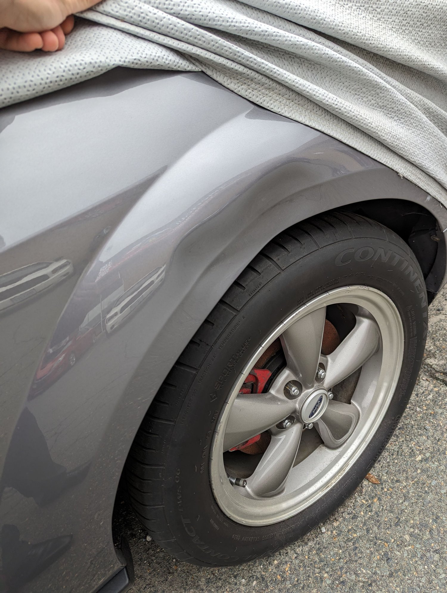

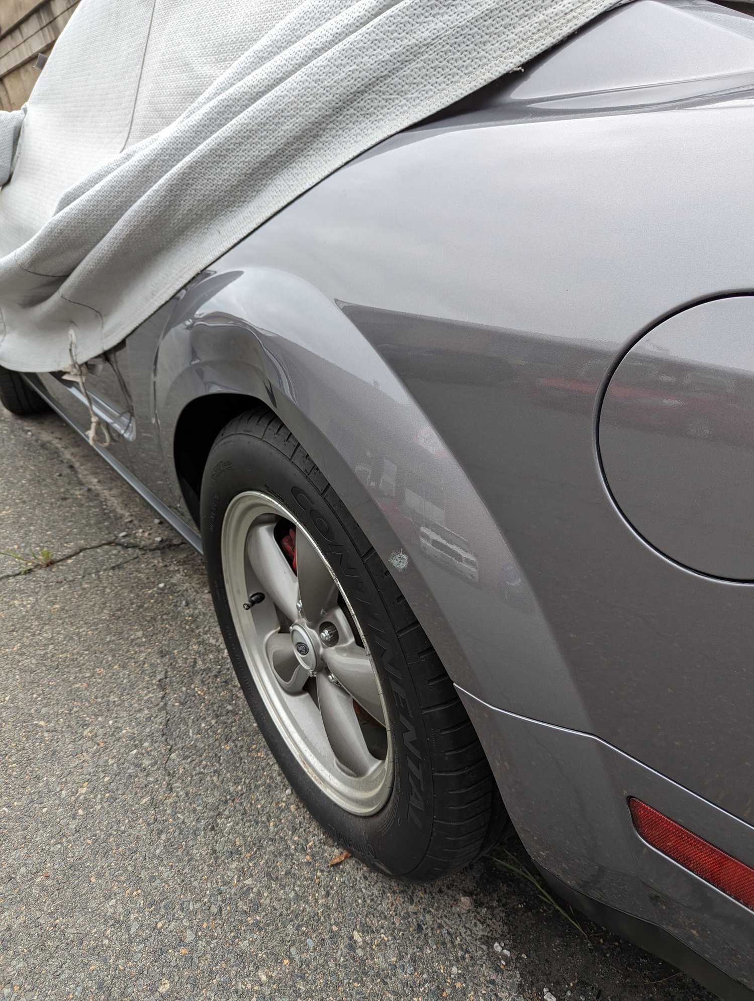

HIT a literal wrinkle

I pointed it out to the guy at the shop when I stopped by, he said they'll take care of it. They've got a security system too so they can figure out who it was and go after them. But again, they told me they'll handle it. Silver lining, because the cover was on it, there's no scratches and there's no bad crease on the fender. I've seen some pretty gnarly dents taken out with painless dent repair, so I'm optimistic that they'll get it pulled w/o too much of a problem. Still ...

Man that sucks. Yeah unfortunately my shop has literally no where else to put the car, but it really bugs me. I asked them too if this's the first time theyve had this happen and they said unfortunately not (I got feelings on that). They've been a great shop to me since '08 so I know they're great at what they do and they've always been honest and upfront. So I know they'll make good on it, but maaaaaaaaaaan I really wish I'd thought about towing it home sooner.

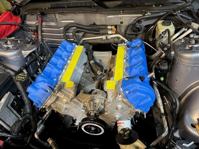

Unrelated to the dent, they got the blue powdercoated valve covers in and yes they are b-e-a-utiful. Wish I'd gotten them years ago. Now how to keep them clean?

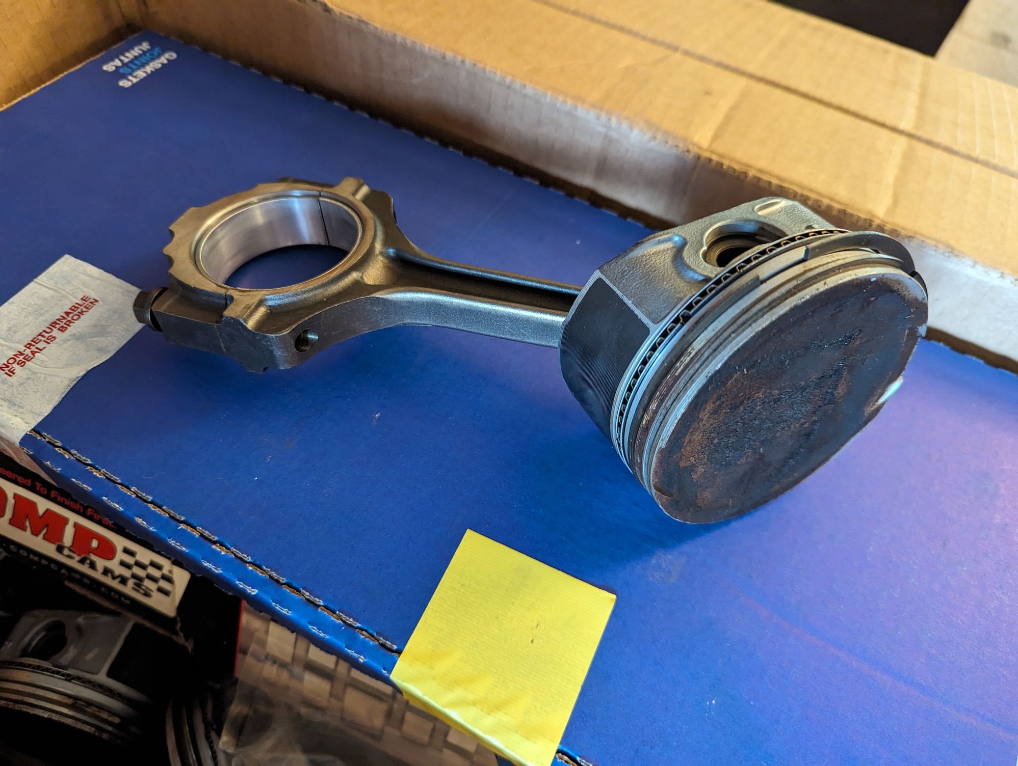

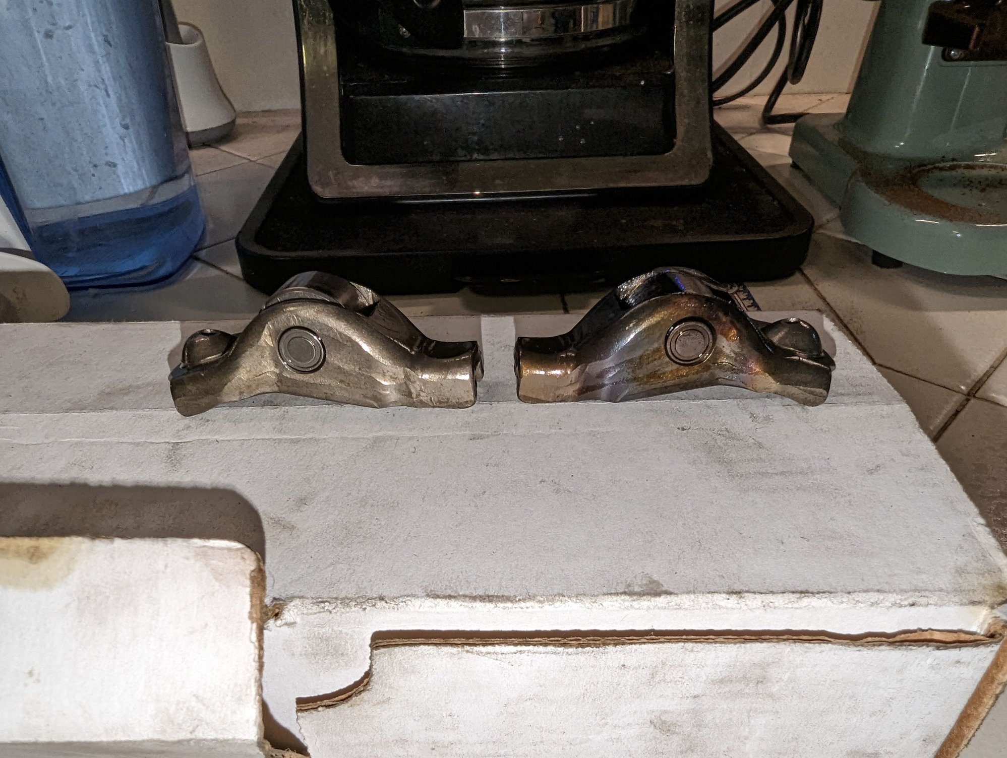

Well, um... yeah so this happened.
Old May 18, 2024 | 03:19 PM
  #71
Cavero's Avatar
Joined: February 13, 2006
Posts: 2,523
Likes: 150
And I got a box of goodies for my Wall of Pain. I'll get a pic of the cam later, it's very obvious which roller failed. The cam's ground down like an 1/16th of an inch. It kind of stuns me how small and LIGHT these pistons are

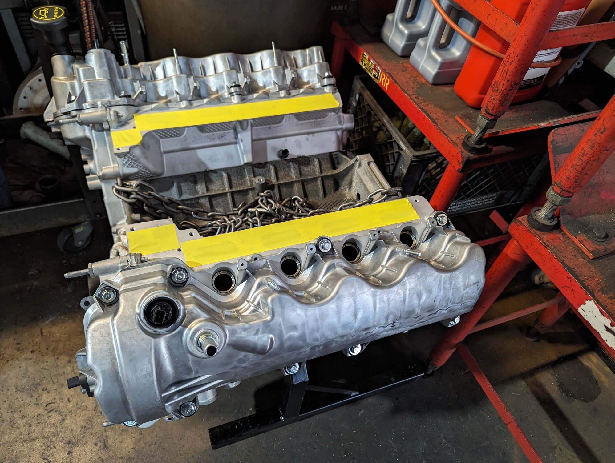

Old May 27, 2024 | 08:27 PM

Wow, looks great.

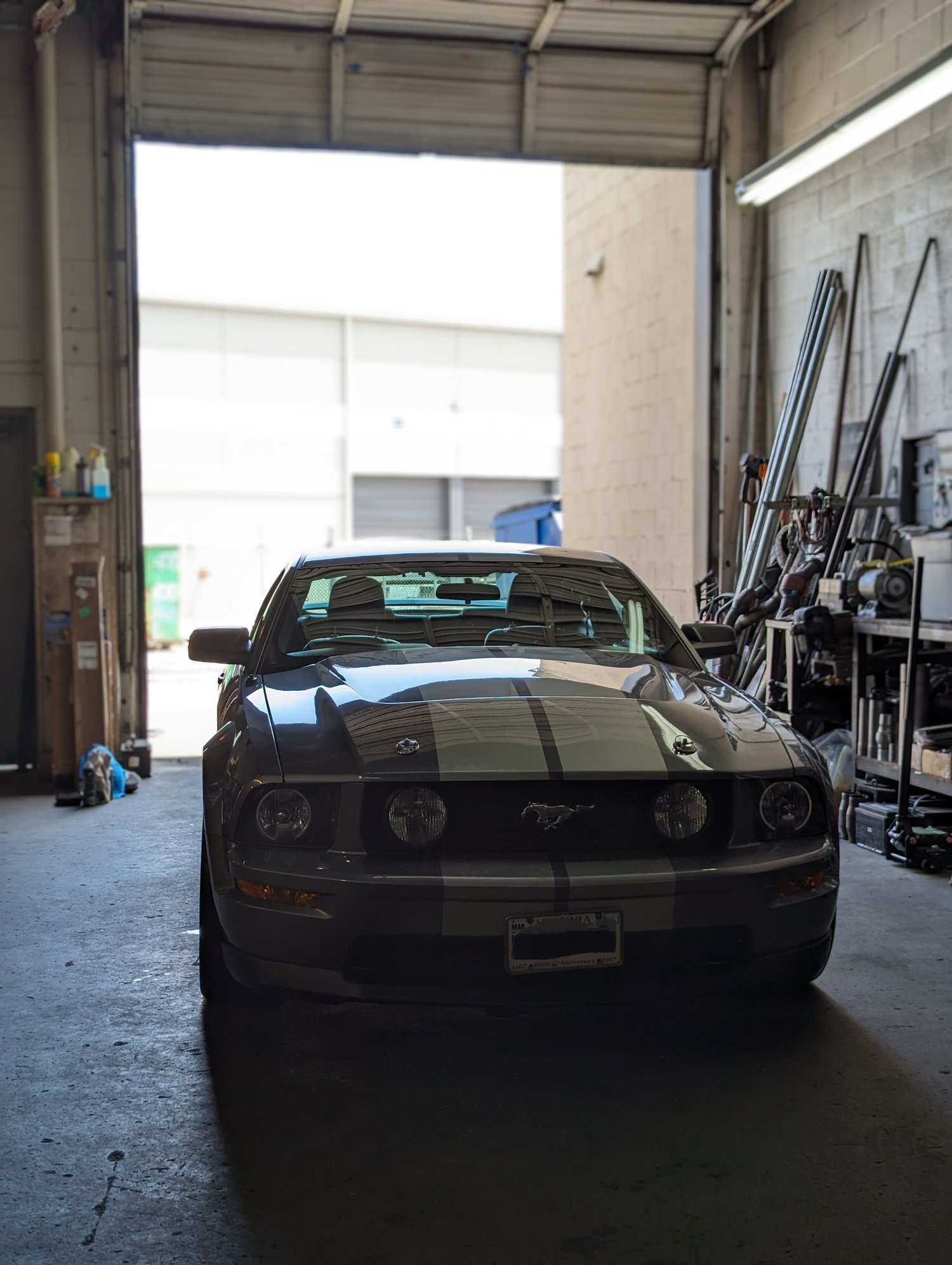

Meant to keep up with updates more, but it was a bit of a rush this weekend. Long story short, I got a call Saturday morning saying she's ready for pickup and I can come get her anytime. So if course I'm rushing the family to get ready and out the door like a kid on Christmas morning. We talked about the break in, they said 300 miles was enough, just treat it like a new car, vary the speeds, go easy on the clutch (also new), keep it under 3500 RPM. Been driving it all weekend, got 165mi so far. They're holding off on the dyno until the break in is over.
She runs great, the comp cams 127450's definitely run lopier than the 127400's that were in it (feels like a cammed muscle car now instead of the stock-like idle it had before). Seems torquier down low with either these cams or the stock intake manifold back on (vs the FRPP manifold I had before), but the dyno will tell.
Only issue is on cold start, it wants to rev to 3000 RPM, so I've been using the clutch and brakes to hold the RPMs down for a few seconds until it settles down. Something the shop will have to adjust in the tune
Anyway, first start with the keys back in my hands (they put 60 miles on it during tuning so not actual first start)

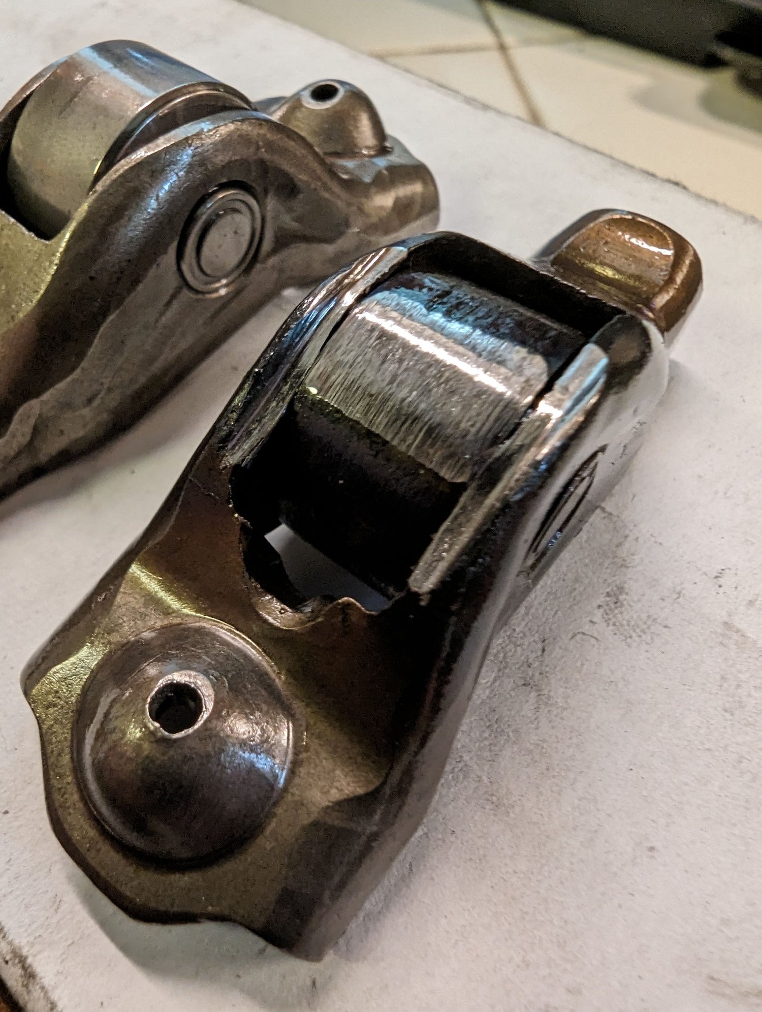

And I was going through the box o' parts and found my 5-figure roller (at least that's what it cost me for this rebuild). Check it out: (and look at the heat discoloration!)
The passenger side had a few lobes that had advanced wear, but only one had this level of destruction. The driver's side is pristine. Makes me think some kind of oiling issue.

Great job so far, first startup vid sounds great. And would you look at that rocker? Wow.

Yeah, seriously I wonder if it cooked like that when it failed or if it was the road trip up to NJ that did it in.
