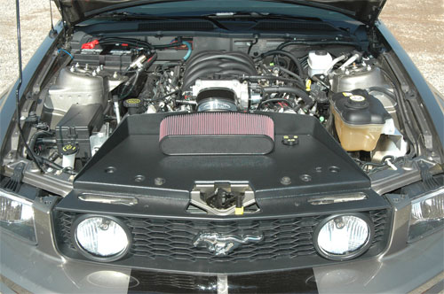

Is there anyway that you can force more air into the engine compartment to allowe the CAI to breath more? Such as a fender wall or lower grill tube to make more air come into the compartment. I know it sounds off the wall but I think I seen a picture with a tube coming from the frint gill and a hole in the fender (nicly done). I hope everyone doesn't think I'm but I think i'd be cool and .
Please advise even if it to say no way.

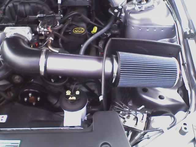

Because of the way our cars are designed, there isn't much fender well to pull air from. (wheels are pushed so far forward)
After installing my CAI and then a Roush front fascia I really started looking at how the air flows. Looks to me like it comes in and hits the wheel well liner and goes straight up to the filter. Also, almost directly under the filter there's an triangular shaped opening in the framework that probably allows air to go up to the filter. If there wasn't a big bundle of wires going through that hole it would be a great place to run a hose from the front of the car.
Another alternative would be to cut a hole in the wheel well liner and attach a hose to it with it going to the filter. Wouldn't be "ram air", but it would be cold air.
It's amazing to me no one makes an enclosed air box that doesn't allow any hot air in. S&B would have a great product if there wasn't a HUGE hole in the back side of theirs. I hate the homemade looking CAI's that are out there right now.

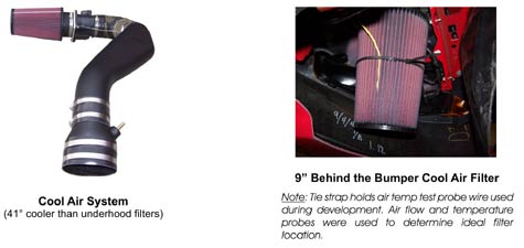

The best thing I've seen is Kenne Bell's supercharger, which comes with a CAI that draws air from just behind the bumper, way down low. That's a true CAI, unlike the MMR one that I have on my car, which basically just relieves the restrictions of the stock airbox.

Originally Posted by GTJeff
Take a look at MRT...
Looks good. Maybe I can adapt it to my Airaid if they would be willing to sell the box seperately. (I agree with Shea about the tube) But only if they offer it in the black plastic they have in the first pic as opposed to the CF in the second pic.
Any pics of the KB setup?
Hey StangNut.. that box and tube is the KB setup.
Here's the link I got that from: http://www.kennebell.net/accessories...-93mustang.htm
That hose goes down through the fender, and that little scoop goes either in the lower air dam or is attatched below it.
