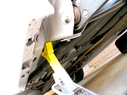

I am in the middle of trying to lower the rear end of my Vert and I am stuck! The chassis strengthening bar won't let me lower the rear differential low enough to pop the old springs out! I tried searching, but no one says anything about this! Do I have to remove these bars too? Or am I missing something simple?

Where do you have your jack stands/jack placed???

I have them in front of the lower control arm, off to the side of the chassis bar...
Old May 27, 2007 | 10:09 PM
I would move the jacks to a different position. I'm not really sure, but that's probably the first thing I would try. If you moved them forward some (rebrace the back, so it doesnt fall) you may be able to get the backend higher, that may help.

I finally figured it out with some help! I jacked up one side which lowered the other and was able to get them out...
The problem I have now is that it lowered the back end quite a bit more than I was expecting! It's close to a 1/2 inch lower in the back than in the front now and I thought it was suppose to level it out (I got the Roush Rear Springs). I am not sure why that is...

Been there, done that. You have to remove the bars. I believe there are 2 or 3 bolts in the front, maybe 2 in the back, but the hard one is the support bar that goes straight up. You will need about 18" of extension on your socket to reach it. The bars look like an upside down "T".
I did it with a Saleen spring set and had to take them out to get the springs out. Otherwise the axle drops and rests on the support bars, which are not designed to handle that weight!

Okay, I finally drove it around a bit and washed her up... So far, I can definitely tell the back end is stiffer, but not *bad* stiff... Just noticable (and also cause I am trying to feel differences)... Over speed bumps, it's tighter and not as *spongy* as the front ones. Overall I am liking them and after I drove it around a bit, I took some more pictures...
Also, I was able to get the stock rear springs out without removing the bar, thank God! It was a bit of a trick, but it worked!
