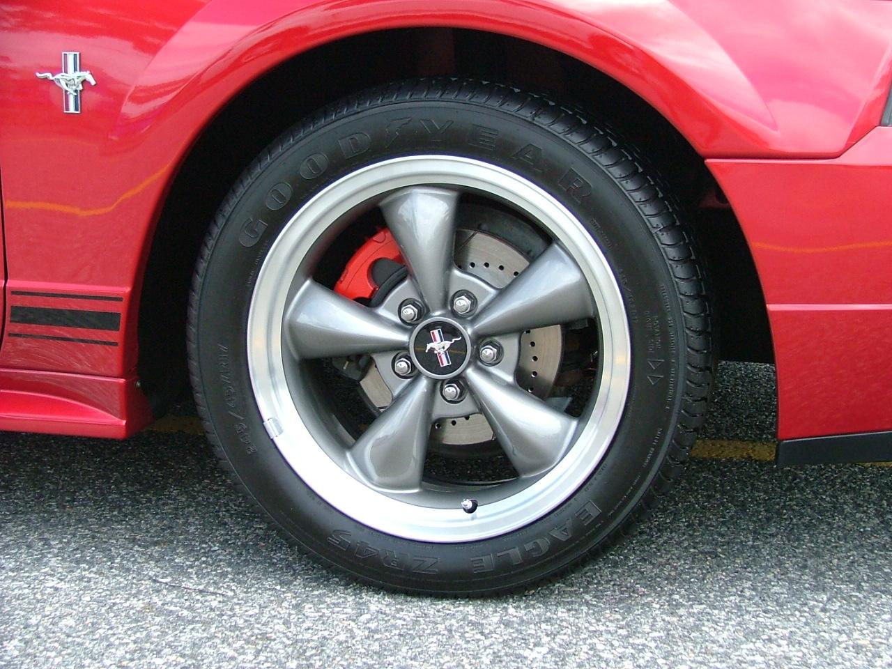

Ford racing sells a set of cross-drilled/slotted rotors. I put those on the front of my 2000, along with some good ceramic pads, and I think it made a nice difference. Plus, it was quite affordable. The rotor set is $150 and the ceramics were maybe like $50-60 (I don't quite remember what the cost of the pads were). I believe that the rear rotors are priced similarly, or slightly less.

Here's a pic of what they looked like, with a painted factory caliper
