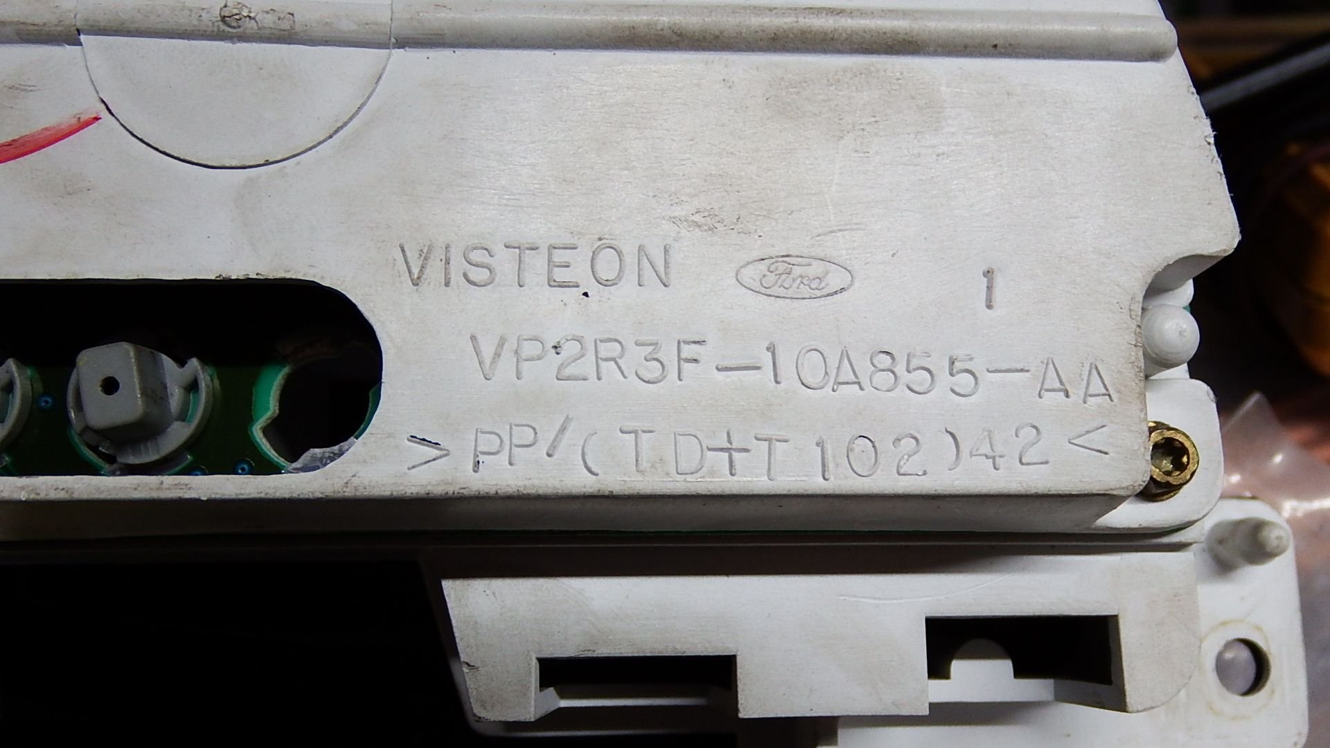

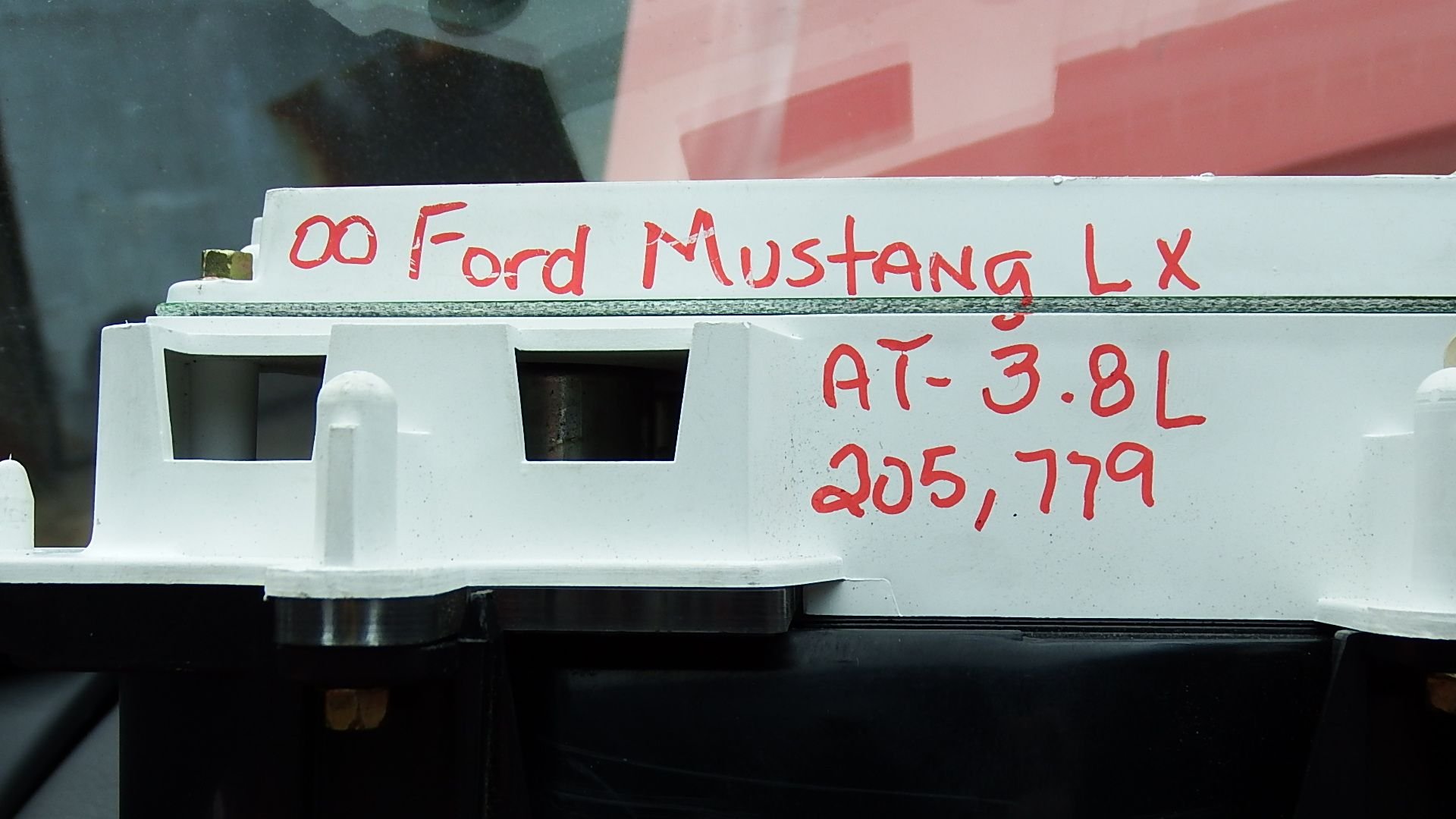

When you're buying a dash pack - this is exactly what you need - well done Jessies Auto Recycling
This isn't - 9 out of 10 dash packs for sale were quoted as having this part number - yep - you guessed it - its the part number of the rear casing which they all have!
You have to wonder why these breakers haven't noticed that all the dashes they've ever seen have the same part number?

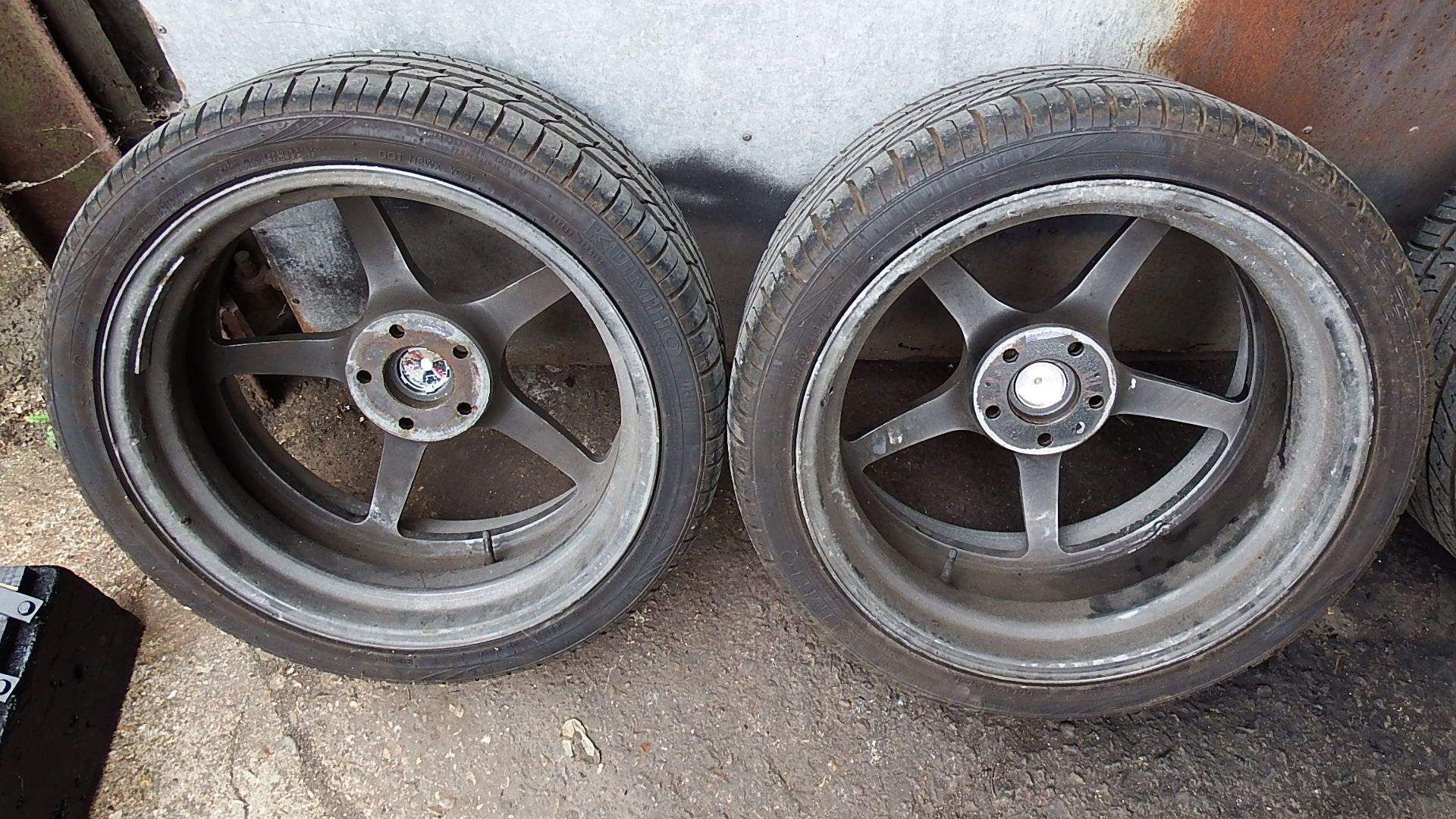

Going back to the wheel swap - is this the worst wheel design ever?
Correct me if I'm wrong but you fit larger diameter wheels so you have space to improve the brakes - so why is the valve right where the calliper needs to be?
The well for getting tyres on and off is at the back so that means the tyre machine would have to grip the front rim - I must be missing the point here?
Any way - hears what I had on the shelf -
Not sure if they really suit but it's what I already had

The Clusters Should Have a Base Part Number of 10849. Usually on a Sticker on the Cluster. When we would order a Cluster at the Dealer we would Run the Vin and Use the ID# of the Cluster, it is Similar to the Part Number But Not Quite. Then we had to fill out an online Form with Mileage and Customer Info to Be Programmed at the Cluster Exchange Center. Lets Say Part Number 1r3z-10849-aa Would Be ID# 1r3f-10849-aa Anyway The Example Above is Similar to Your Car and Gives Fit Range.
I would input your Vin to Get Actual Part Number / Id# Number. You are Correct that the Base of the Cluster is the Same on Many Cluster since it is Simply the Base. It is Just a Subcomponent. The Wrecking Yards Use a System Like Hollender Interchange which Says a Certain Part Fits Certain Years Unlike Ford which Make you Look at Each Car One at a Time. Anyhoo enough of the Cluster Review!
As far as your wheels I would Say Hot Rodding is all about using what you got to save a buck. You could have Done a lot Worse. Is an odd spot for the Valve Stems. Maybe get some Angled Metal Stems for Easier Access! I am Old School and I would strip off the Black from the wheel and polish them. But Thats me! Pretty Clean Car By the Way!
