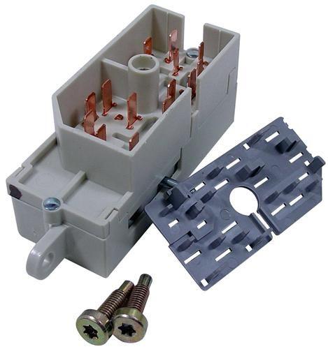

Have you Checked out the Ignition Switch? This Particular Part Number Switch was Problematic back in the Day. They would Separate and Cause all kind of Issues and they are Plastic. They really failed a lot on Vehicles which had Extra Accessories tied into switch. They would usually have Hot spots on some of the Terminals upon Inspection. This Switch was used from the Early 80's to Probably Mid 2000's I sold a Lot of them. Ford Number F4DZ-11572-B

Interesting you should point to the ignition switch
Have already had it apart and cleaned all the contacts when it first arrived - nut that there looked to be anything wrong
A bit of colour on some of the contacts but nothing like burns or corrosion
Any way - have ordered a new one but will have the column apart again and have a look

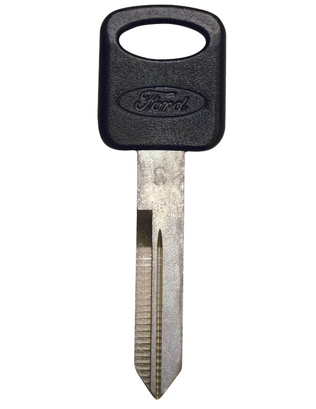

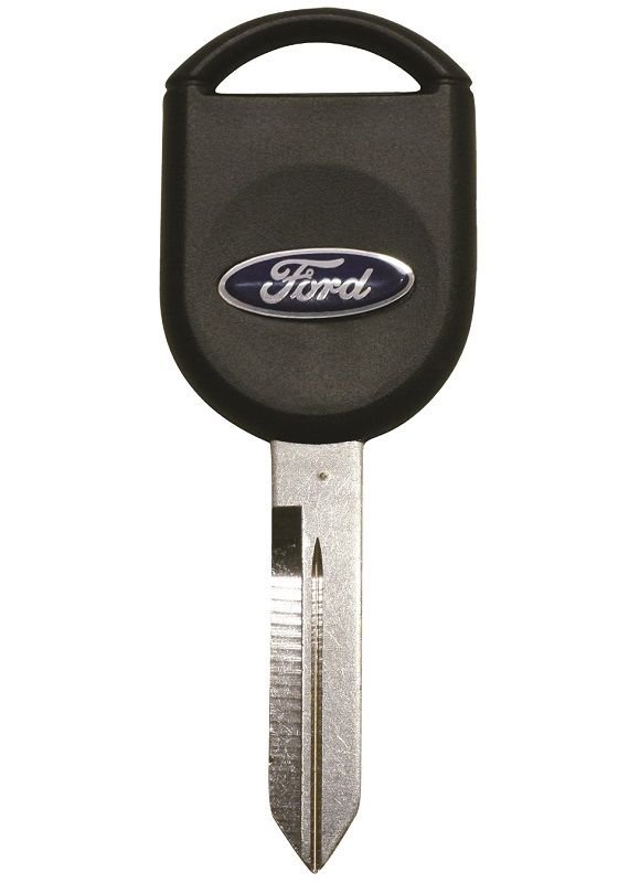

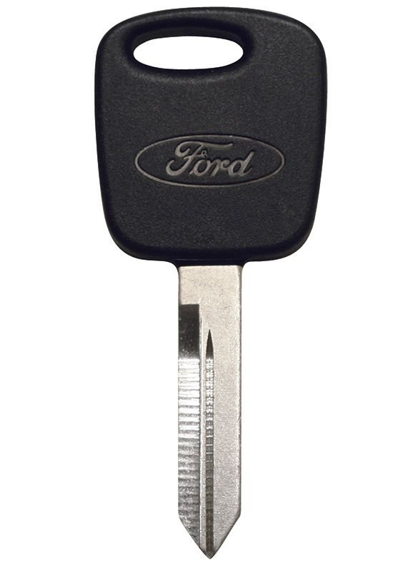

The Clusters are Fairly Problematic. FOMOCO usually Stops Servicing them at the Dealer Level around 15 Years.
Pats Started in 1996 But Not on All Cars Produced. A Lot of Fleet Vehicles Such as Police Did not Use it Cause they Needed One Key Code to Fit all Cruisers! My 06 Police Interceptor Does not Have it!
Sorry Don't Know about a Jag Rack!
Oh and As We Say to Our Military in the States!
{THANK YOU FOR YOUR SERVICE}
SALUTE!
See Pics For Key Styles! Ez Way to See if it was PATS!
KC
NON PATS KEY Top
EARLY PATS KEY Middle
2005-2009 PATS KEY MUSTANG Bottom

Oddly enough - the one with the off centre hole which I think you say is none PATS is what all 3 of my keys look like
I have 2 genuine keys and one that has no logo - pattern?
On the genuine keys, you can clearly see where the chip is hidden - the coppy must be moulded in - you can't see anything

Top is Non Pats, Center is Early Pats and Bottom Is 05-09 Pats. Relabeled Pics to be Clearer.

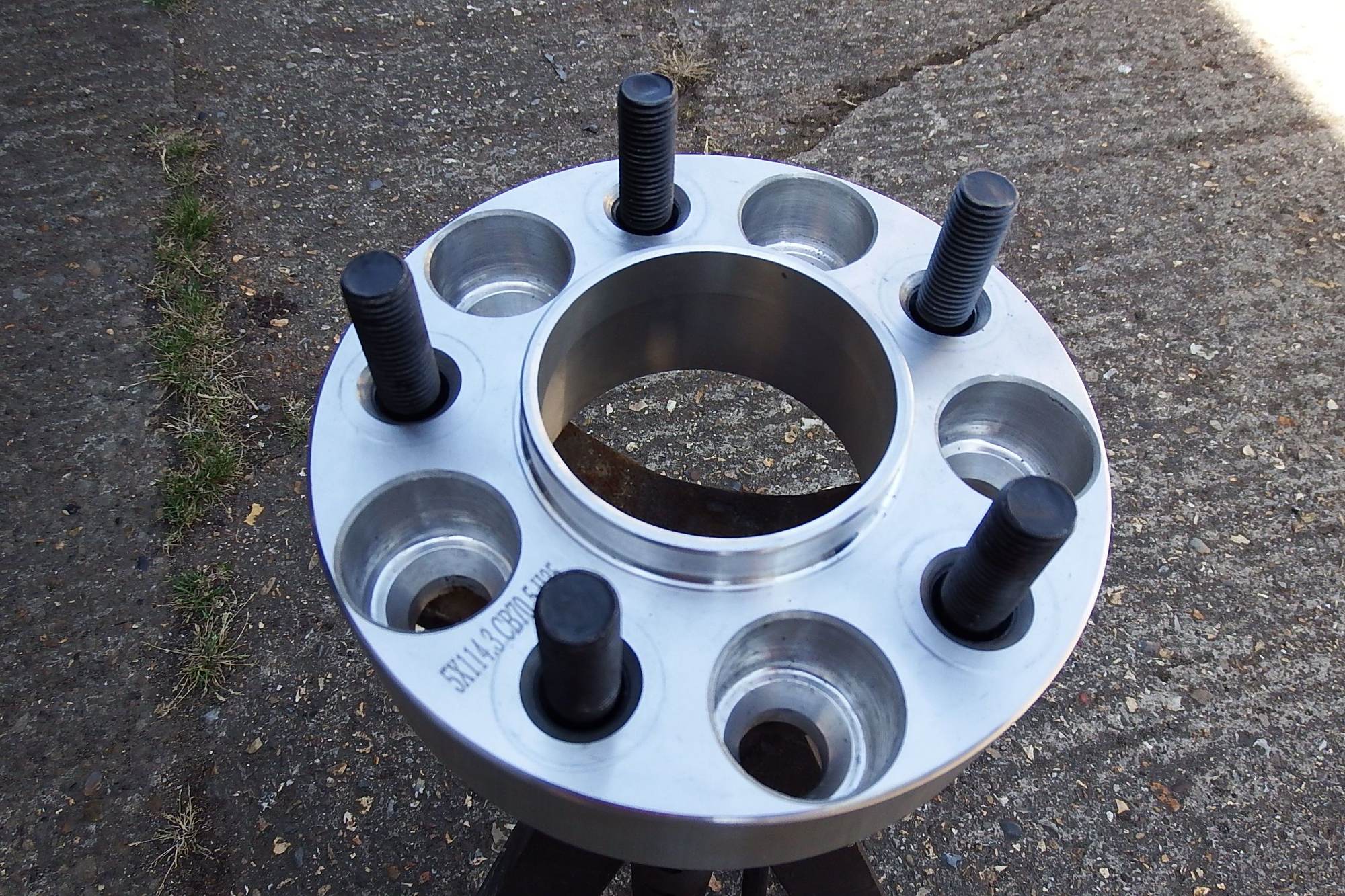

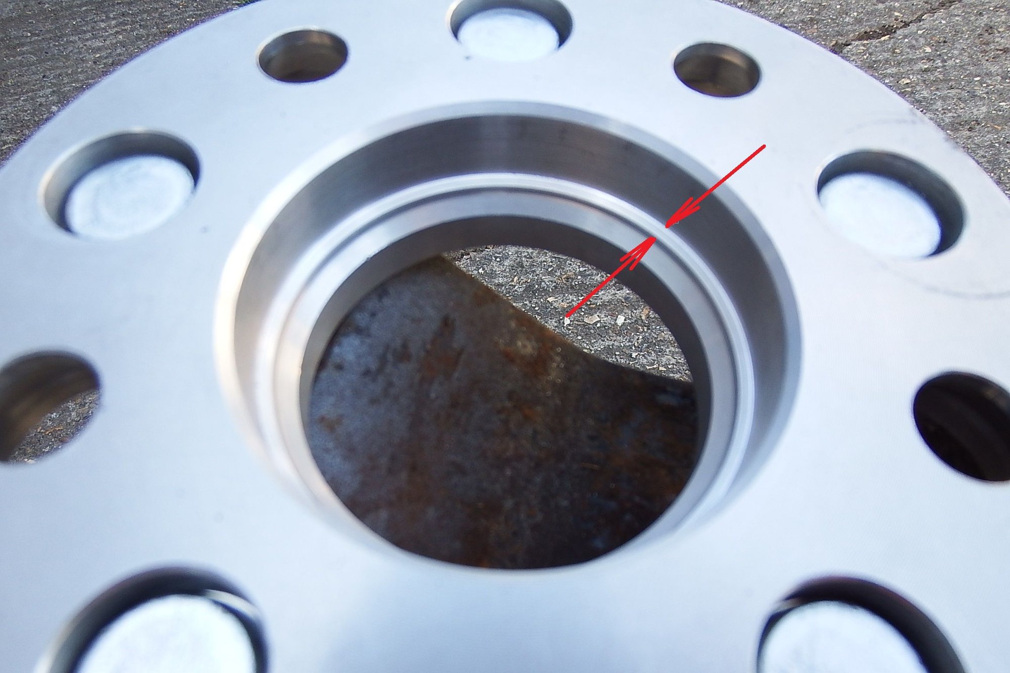

You'd think buying some wheel spacers would be easy but not to suit the Mustang in the UK
Didn't want to spend a fortune so got some near enough and modified them to suit
Wanted 40mm on the rear but was looking at £115 ($135) for a pair - found a set of 4 at 35mm for £60 ($70) which is close enough and had the correct 70.5 centre location.
Had UNF studs so had to change to M12x1.5 because that's what the fancy sleeve nuts that came with the wheels are
This one is 35mm with the 70.5 centre for the rear so just had to change the studs - yea - right!
Turns out the new studs need a slightly lager hole - so pressed all the studs out - drilled them to 14mm - about half a mm larger but enough to be a problem - pressed the new metric studs in

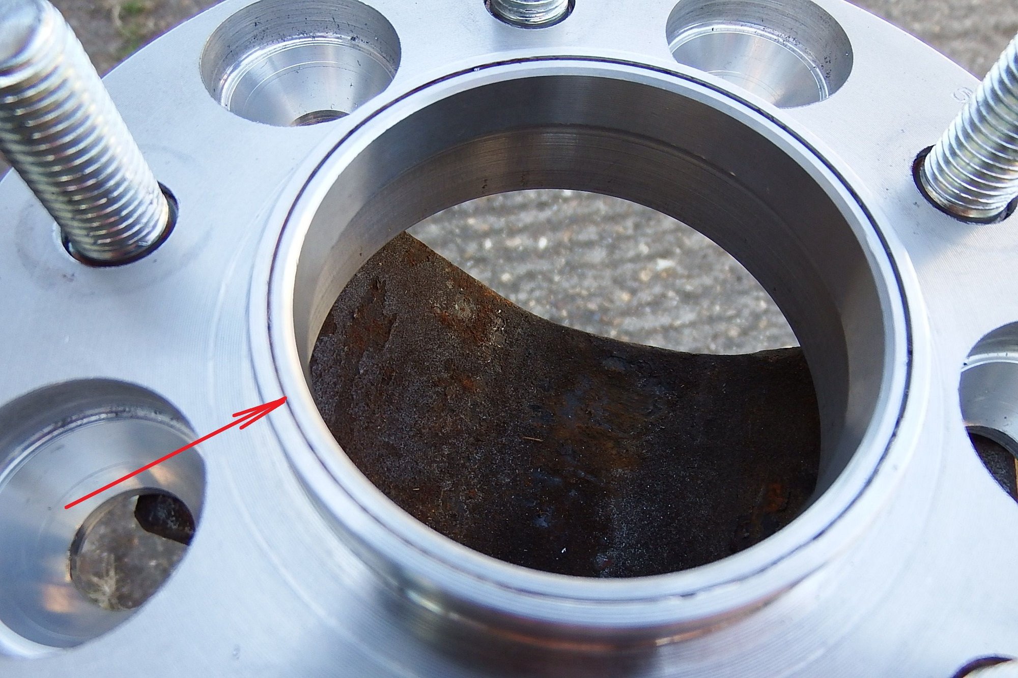

This one is 20mm for the front with the correct 114 PCD but with a 67mm centre location - best I could find - £70 ($84) for these two
To get the centre from 67 to 70 - machined up a ring then pressed it on with green "never to move again" thread lock
Let it go off over night to be sure then machined to the 70.5 required
This thick wall alloy tube is absolutely brilliant for this kind of thing - it's readily available and just buying a short length is easy on ebay - well handy for hose adaptors too
You can see the difference here between the original 67mm bore and the 70.5 I bored it out to

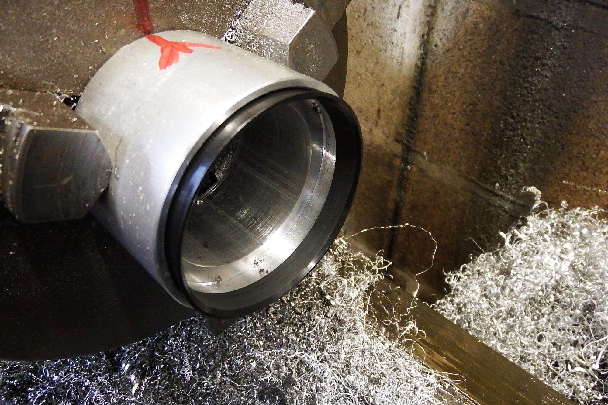

On to the next challenge - can't get spigot ring the correct size to fit the stock 73mm in the wheel to the 70.5 on the hub
Had to go with 73 to 70.3 - you'd think that might be close enough but no - when it's in the wheel the hub doesn't go in and if you stretch it over the hub, the wheel won't go on
Yep - you guessed it - more alloy tube machined very accurately so the plastic ring fits snug - then with a shiny new tip in the boring bar - take very gentle cuts - and that's all there it so it folks!
