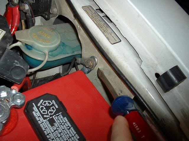

check for codes do a KOEO, check for ecm operation, check ecm ground, check that all injectors are firing, check, check until you are blue in the face.Do a compression/blead down test. This guy is a mechanic correct? he needs to start trouble shooting, I mean what the heck . It gets hard for us to help over inter web, I'm here at home and I cannot hear how the motor is spinning over or see what is going on so this makes things very tuff.
ecm ground location:
If something is up with the computer then you are going to have problems, they have tools to measure spark strength to make sure the coil or dizzy isn't a problem( yes you have spark but what is the spark quality). this is a basic system vs newer stuff ( although the newer obdII gives more info but still)
