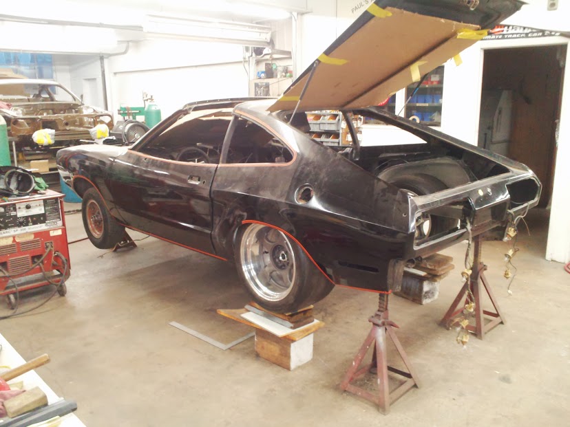

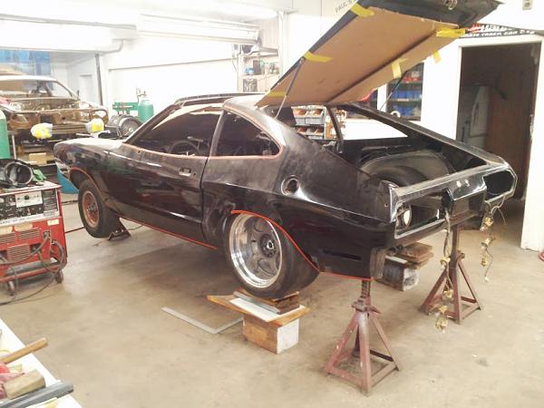

So the shop (Paul's Automotive Engineering) that works on my Mach, has a CLEAN '77 (4-Speed) II (2.3 or 2.8 I believe) in the shop and the owner is thinking about a 2.0 EcoBoost swap. I'll keep you posted if I get updates. Should be a darn cool project!
This is the same shop that is also working on a King Cobra (attached and I think I posted a photo before) and the owner (Paul) has a mini-tubbed II with a 347 and widened Anniversary Cobra wheels.
Attached Thumbnails *Updated* Arin's Uber "76" Mustang II Buildup-2013-03-22-07.26.13.jpg

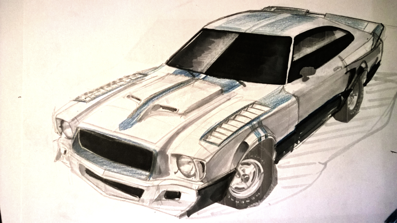

started making some plans earlier today inbetween homework
super rough I know, but I think it shows where I want to go with this car. a little more exciting in the front, a little bit of of the IMSA Kemp cobra, and a littlebit of weird **** I like
Attached Thumbnails *Updated* Arin's Uber "76" Mustang II Buildup-wp_20140416_16_08_16_pro.jpg
