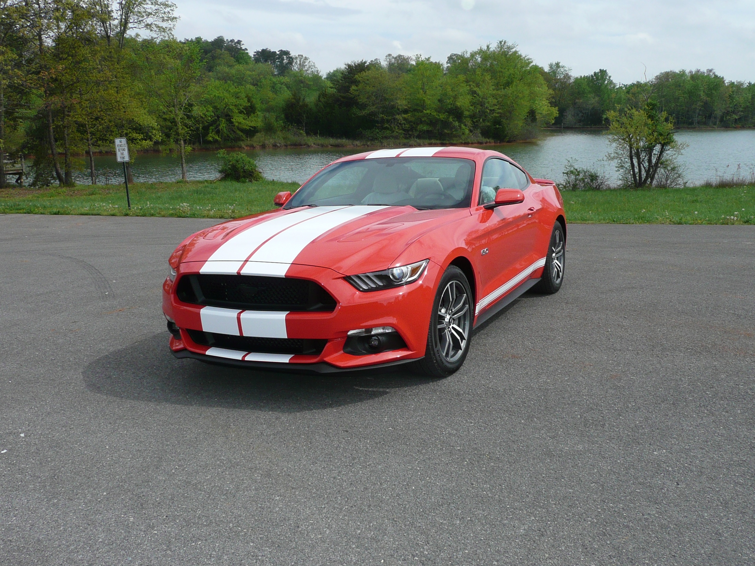

I have a K&N filter and opened up holes in the grill intake.Mine is about 4-5*. My GT500 stays about the same as the outside temp when at speed, so who knows how accurate all these sensors are.
