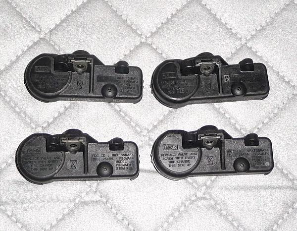

Originally Posted by Ltngdrvr
You will also need to replace the valve stems as well if the ones that were used weren't for stem mounted TPMS.
Correct, that's exactly what it says to do on the sensor. Each time it is dismounted. That's the correct way to do it anyway. Read the info on the round part.
