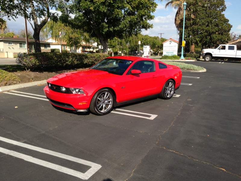

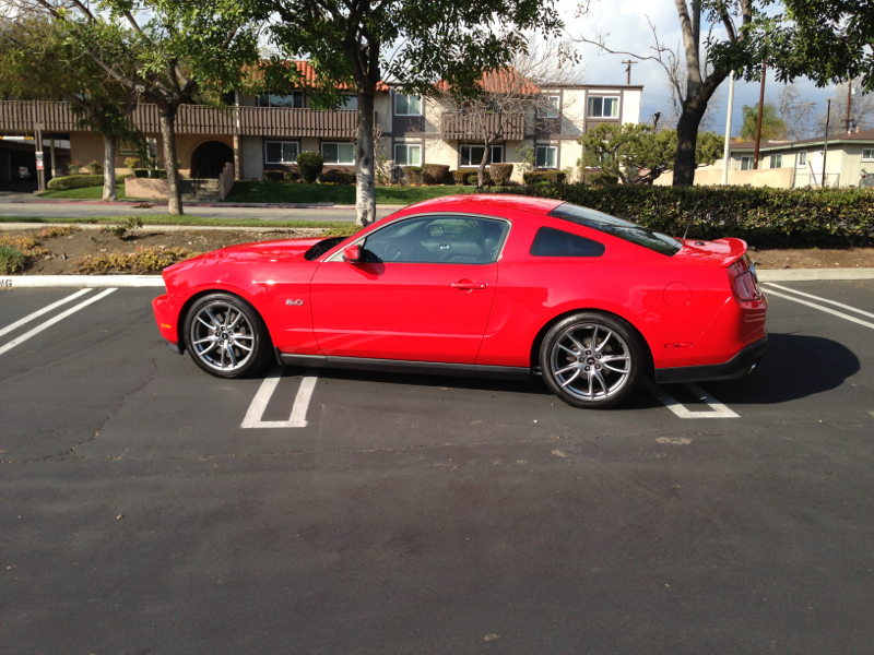

Lol, I figured I owed you. If you have any questions, feel free to ask or pm.
