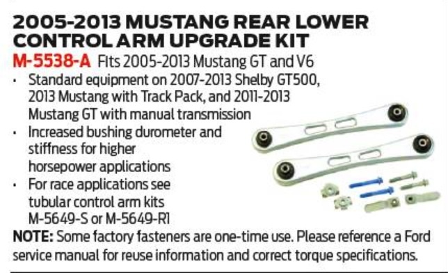

It's not tubular. It's just a higher durometer bushing in the same stamped steel housing. I am told the boss comes with the same one. My friends lca looks the same and he has a boss.

Old Feb 3, 2013 | 08:37 PM
Pilks's Avatar
Joined: September 24, 2008
Posts: 326
From: Morris County, NJ
