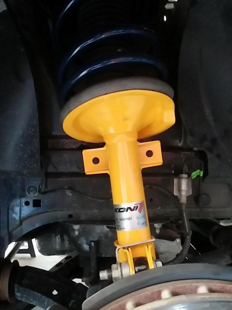

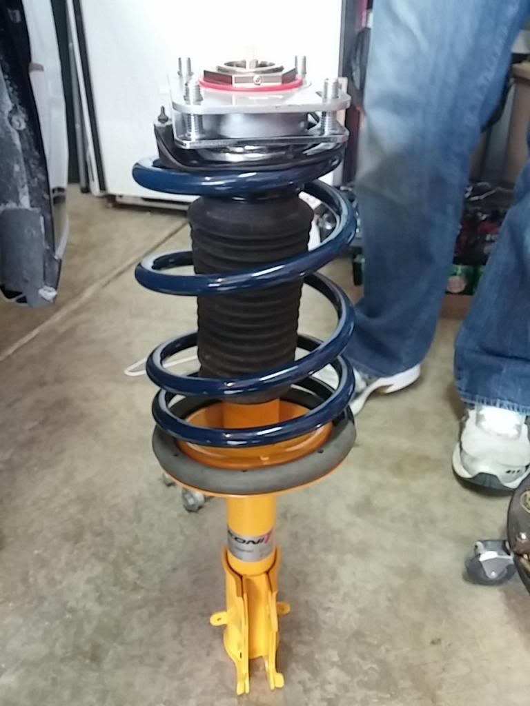

Hi TJ,
Apologies for the delay, been on vacation for a while! Here are a few photos of the install with the konis, Steeda HD strut mounts, Steeda Sport springs and the 2013 isolators.

Originally Posted by tj@steeda
What kind of driving are you doing where you have blown out 4 sets of end links? We have not had many issues with our endlinks ... not sure what you are experiencing as a whole with your car.
As for the original OP and his problem, I spoke to the installers & it is very likely it is your endlinks.
Best Regards,
TJ
We made sure every single nut and bolt was torqued down to spec upon install and checked everything again a week later just to make sure. I figured the endlinks were a long shot, but if the installers at Steeda think it's the links, I'll give a front set a try since I've always heard great things about your products.
Thanks for the help TJ!
