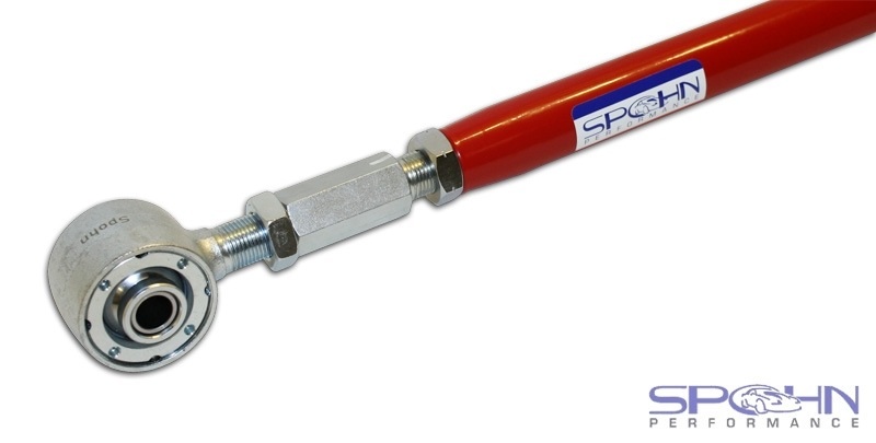

I just picked up a barley used spohn performance adjustable pan hard bar for $50!
It has the del sphere pivot joint on one end and Polly bushing on other.
Has any one heard of this company are they any good?
Here is a pic of one like mine, but mine is black.
If they make good products, I'm interested in there upper control arm.
Attached Thumbnails Have you heard of spohn performance? I need input!-image.jpg

Never heard/seen of this company. The solid metal on one end might add some unwanted NVH. Stock is rubber, most (good) adjustable PHBs use poly bushings.

I was worried about the noise to but this is what they say about it on there web site.
"The Spohn Performance Del-Sphere pivot joint solves the shortcomings of the factory rubber and aftermarket polyurethane bushings. Our Del-Sphere pivot joint incorporates a spherical ball which is surrounded by delrin bushing cups. This combination allows the panhard bar to articulate like a spherical rod end (28 degrees of available rotation) during cornering but the spherical ball does not allow the bushing to deflect. Therefore the panhard bar remains completely bind free like a spherical rod end during cornering for predictable traction in the corners. Think of the Del-Sphere pivot joint as a Delrin bushed spherical rod end. After over a year of R&D testing here at Spohn Performance on a streetable spherical joint the Del-Sphere pivot joint is the final result. Designed and manufactured exclusively by Spohn Performance, we have taken street suspension performance to the next level. Our Del-Sphere pivot joint features a one piece forged and heat treated chrome moly housing, a heat treated and chrome plated chrome moly spherical ball, Delrin bushing cups, heat treated retainer washer and snap ring, heat treated and chrome plated chrome moly threaded adjuster ring, an external grease fitting and a beautiful silver zinc plated housing finish. The Delrin bushing cups absorb shock and road noise so you get the quiet and smooth ride of a bushing as well as 28 degrees of rotation!"
I guess I will find out how it works once installed, I will keep everone updated!

That's a pretty interesting design actually. I would be curious how that bushing would drive compared to a std. spherical bushing that other folks like Kenny brown use in their LCA

I just wanted to give a update, after installing the PHB, along with a pile of other parts, there is almost no additional NVH in the vehicle!
I would recommend this part to any one, very easy to adjust on car as well!
