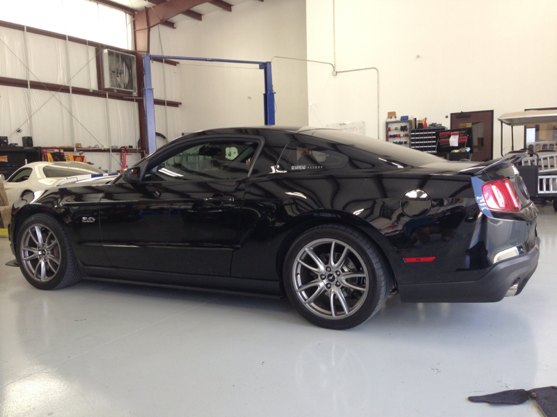

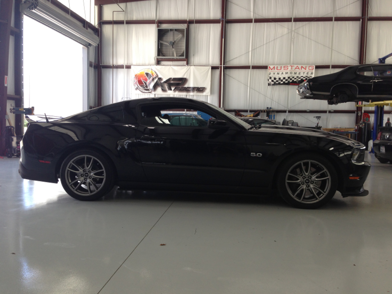

Well I like the front struts, but as of now I can't figure out how to adjust the rear shocks. They were on a Texas mile gt500 so they are super soft, not ideal for street use at all. They are the cobra jet adjustable shocks (m-18000-cj).
Here's how it sits with the L springs

Does it sit level or is there more gap in the front? The shadows are messing me up. I'm seriously considering these springs, as I have SVTPP shocks and struts on my car right now and these springs are designed to work with those dampers. I thought about doing P springs, but I don't know if the spring rates are similar.

I think it is more leveled than when I had stock shocks and struts with P springs. It definitely doesn't have a reverse rake. I'll measure when I get home to give you exact ride height.

The height from the ground to tdc of my fender well is 28" up front and 28 1/8" in the back. Has a nice level stance
