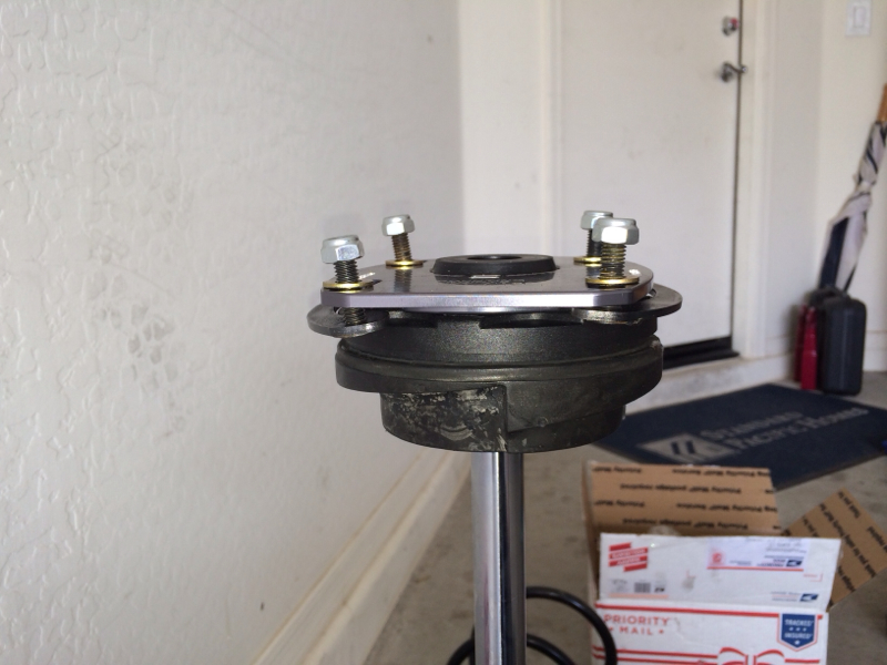

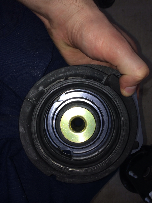

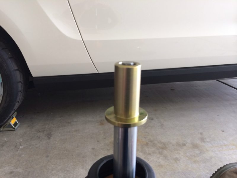

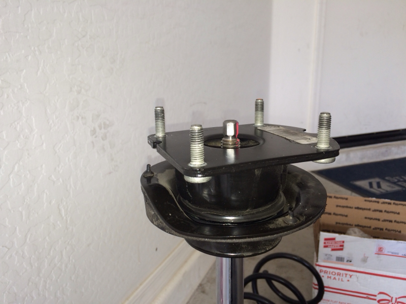

I'm installing koni strts 11+ with bmr springs and ground control cc plates. I'm doing something wrong, I have to be. I can't compress the spring anymore and I don't have enough room for the strut nut to even start. Here's some pics of the cc plate sitting on top of my stock strut and a pic of the stock strut mount. Any help is much appreciated. I'm screwing something up, have to be lol.

Here's the middle piece that prevents it from allowing me to get the strut but on.

I'm sure there are some who would like to know what the deal was.
The washer there in the last pic is for 05-10 struts. I have the 11+ Konis.
