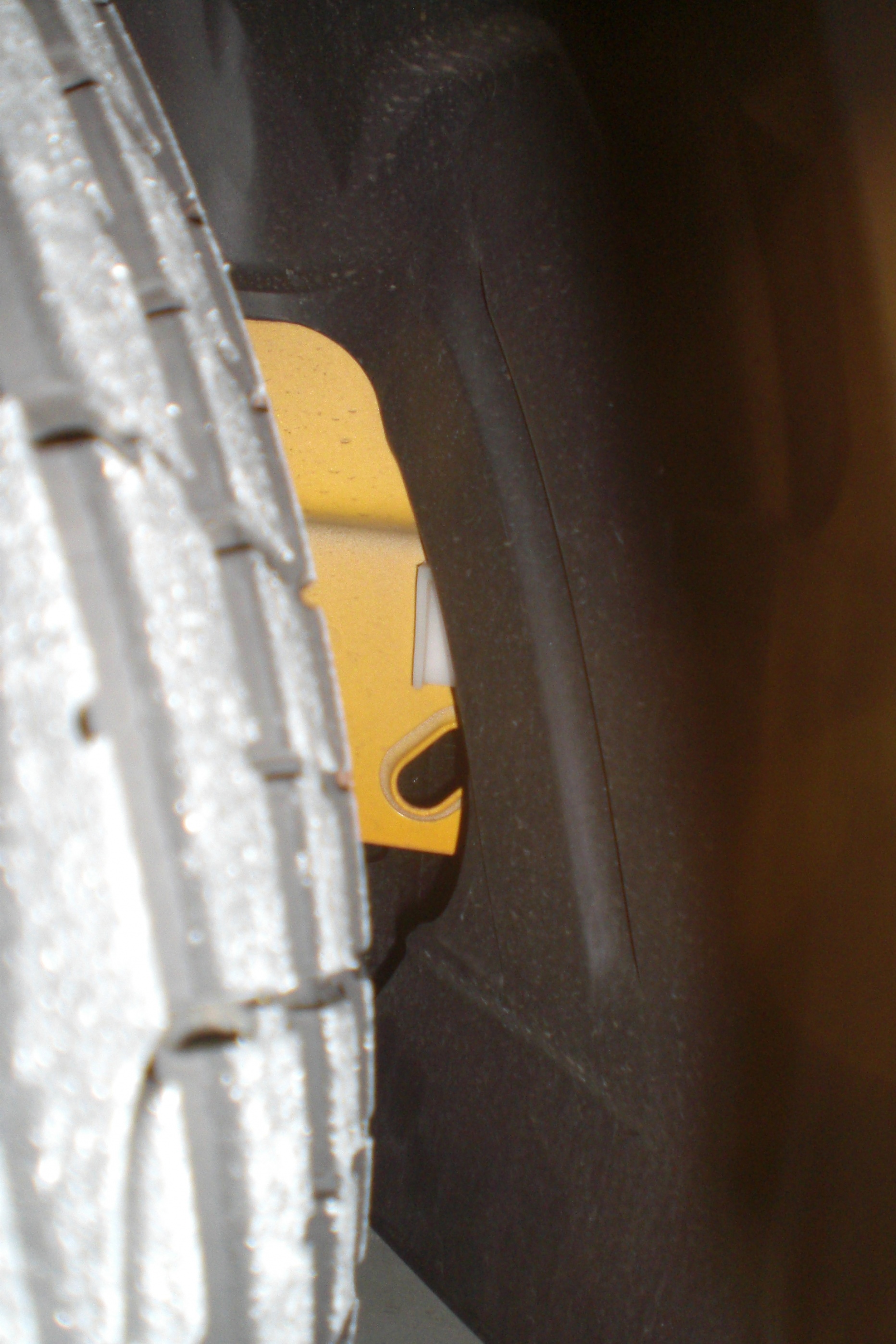

What Gary said is the best I have come up with also. There are some true T-hook locations on the inside of the front wheelwell but they are too high up to help unless you have a rail built into the trailer for tie downs. I ended up getting a few axle straps for the back and use the lower control arms up front.
The frame has no true T-hooks but to pull the car up I modified a hole in a front crossmember to accept a T-hook. Helps if you don't want to drive up like me on an open trailer, I can send you pics if you would like.
