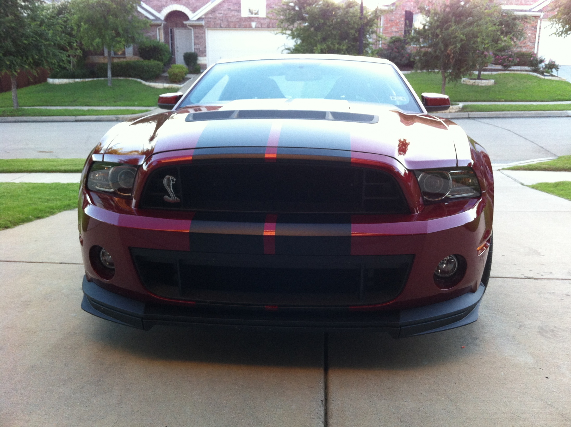

Well, I did bring my Ford to the dealer Deysha. They made a very convincing argument to leave with a different Ford. Problem solved.

Nice !!!

That is one nice looking ride, BadBoss1930!!
