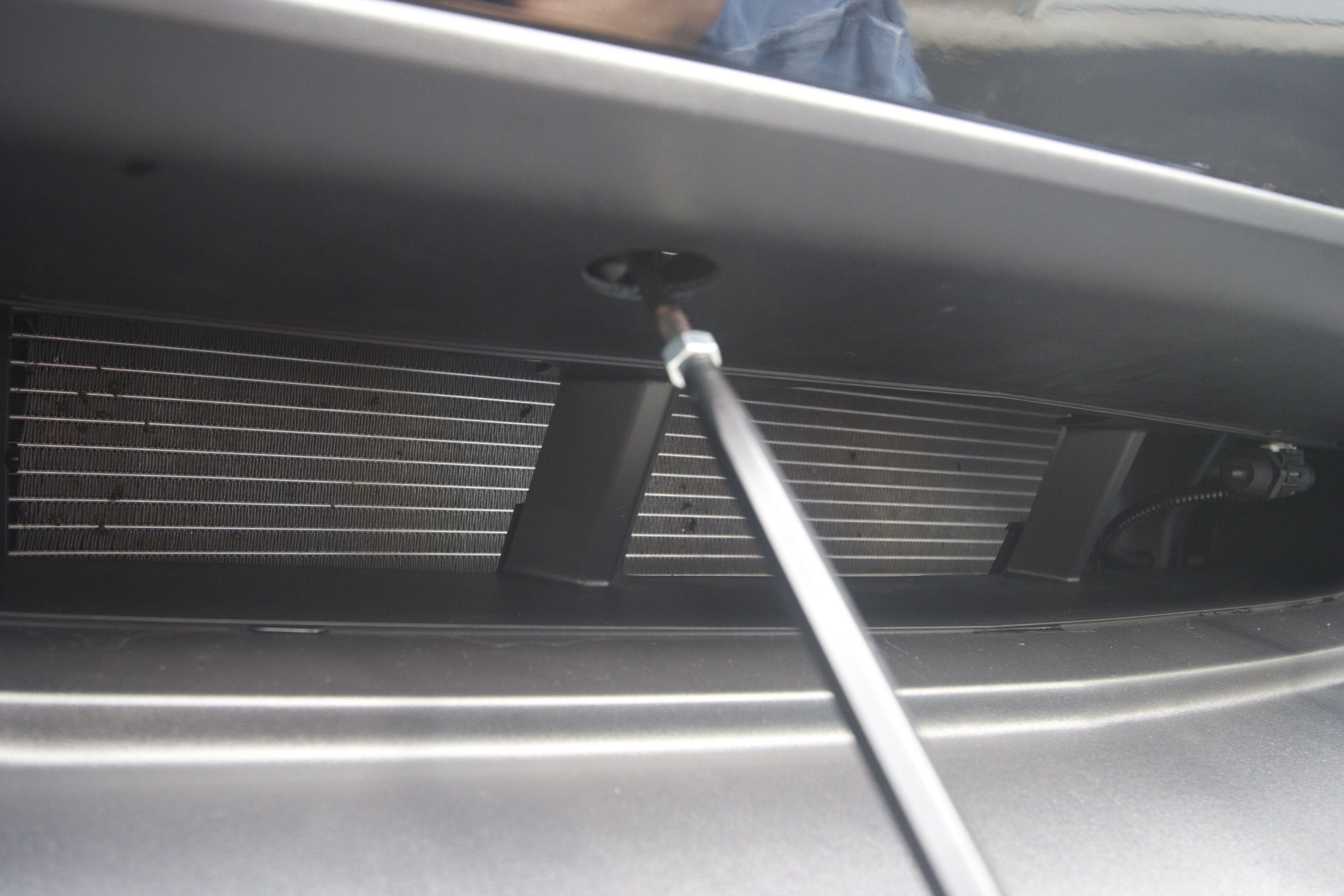

So I got the extra LS parts this week. The transmission scoop was simple. The brake cooling ducts were a pain in the butt due to the ducting not being big enough to fit over the caliper bracket. I eventually got it, but it took me way longer than it should have. The splitter was easy - until it came to the dang splitter support rods of all things. The attachment threading on the bumper bracket is threaded vertically, but the holes in the plastic part of the bumper are angled. How on earth does the top of the support rod thread into the bumper bracket without removing the bumper or cutting the bumper? Has anyone done the splitter install yet and know what I am talking about? Does anyone have a solution? I don't want to cut the bumper nor do I really want to take it to a dealer when I am at a 98% solution right now.

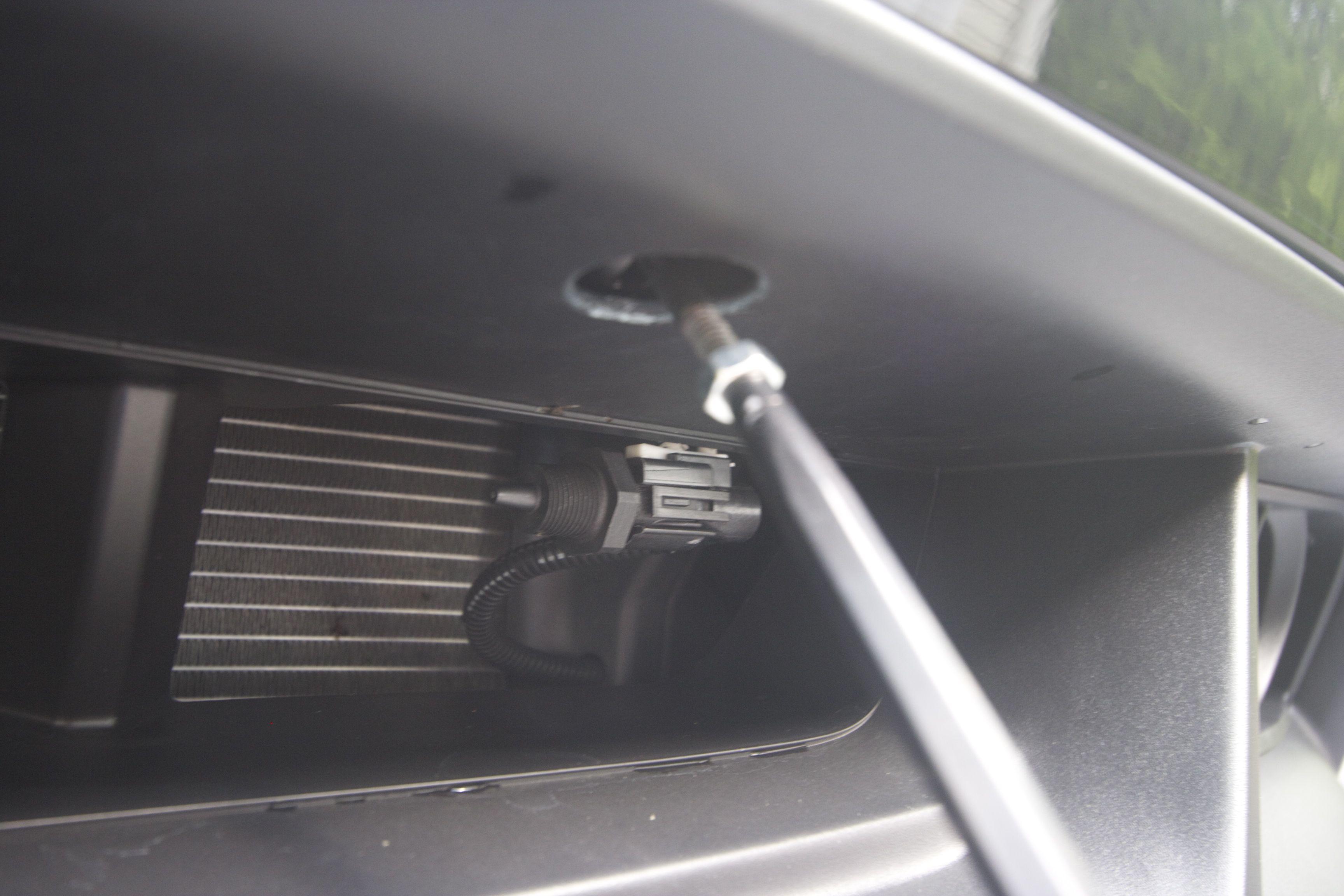

I got them on. It took a while to figure out. You really have to push up the plastic piece on the bumper. Eventually the screw head will bite. Not easy and it felt like I was going to break something. Once the first one went in and I understood the technique, the second was easier. Ford could have made it very simple if they drilled the two bumper holes about 3 cm back towards the car.

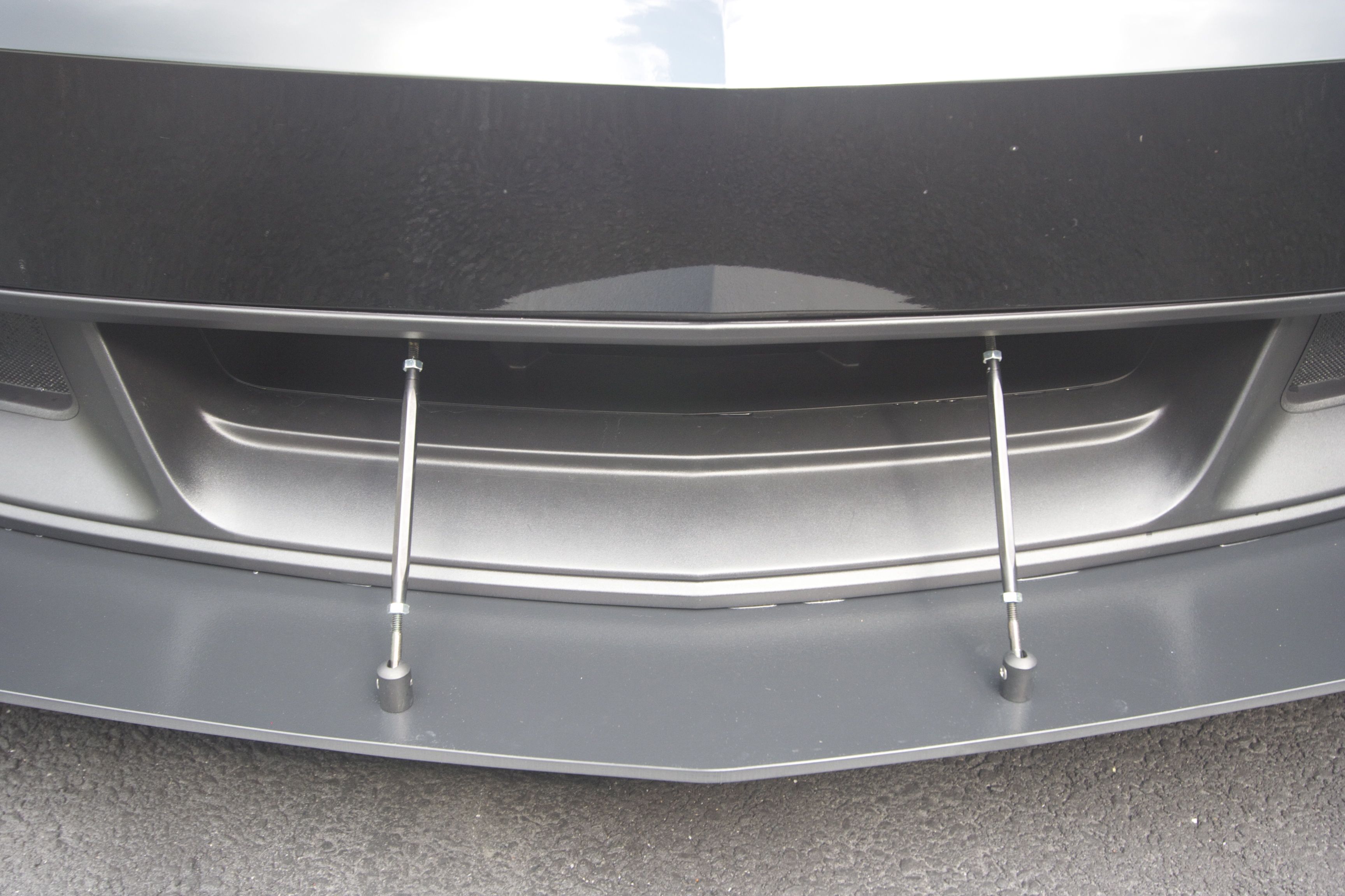

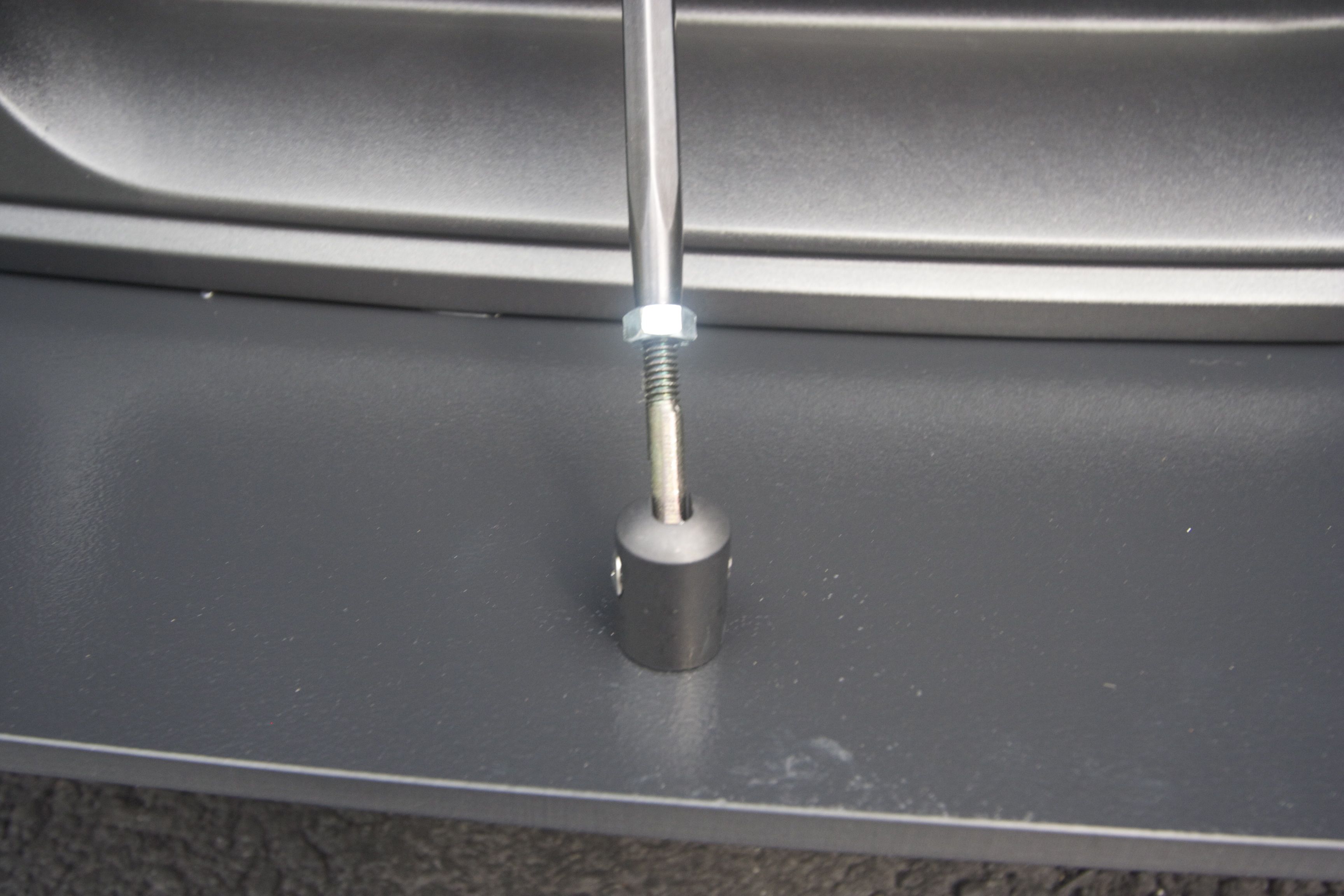

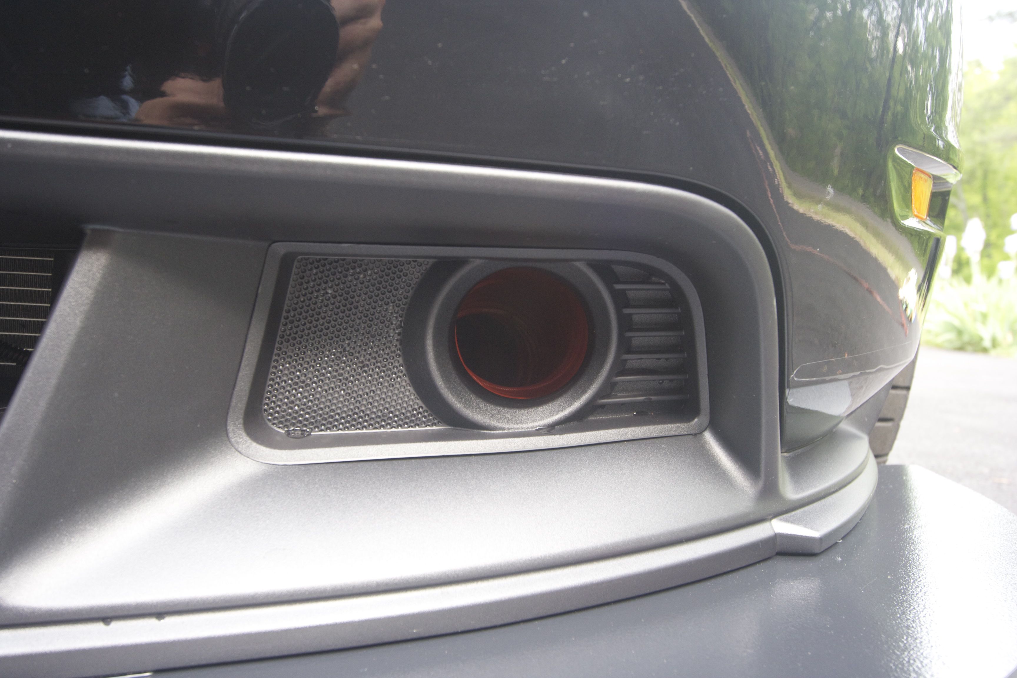

The instructions say get some black silicone and use it in the eyelets. I definitely recommend it. Otherwise the supports are loose. For the brake ducting, its going to suck getting them on the caliper bracket. I actually cut some of the metal in the ducting so it would stretch a little in order to get it on the bracket. Make sure the ducting goes along the inside (towards center of the car) of the washer fluid reservoir.

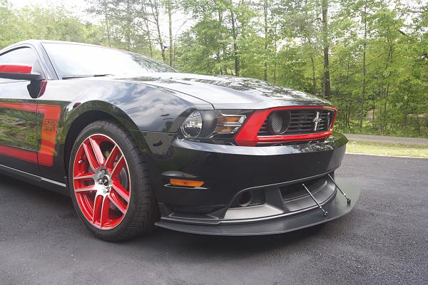

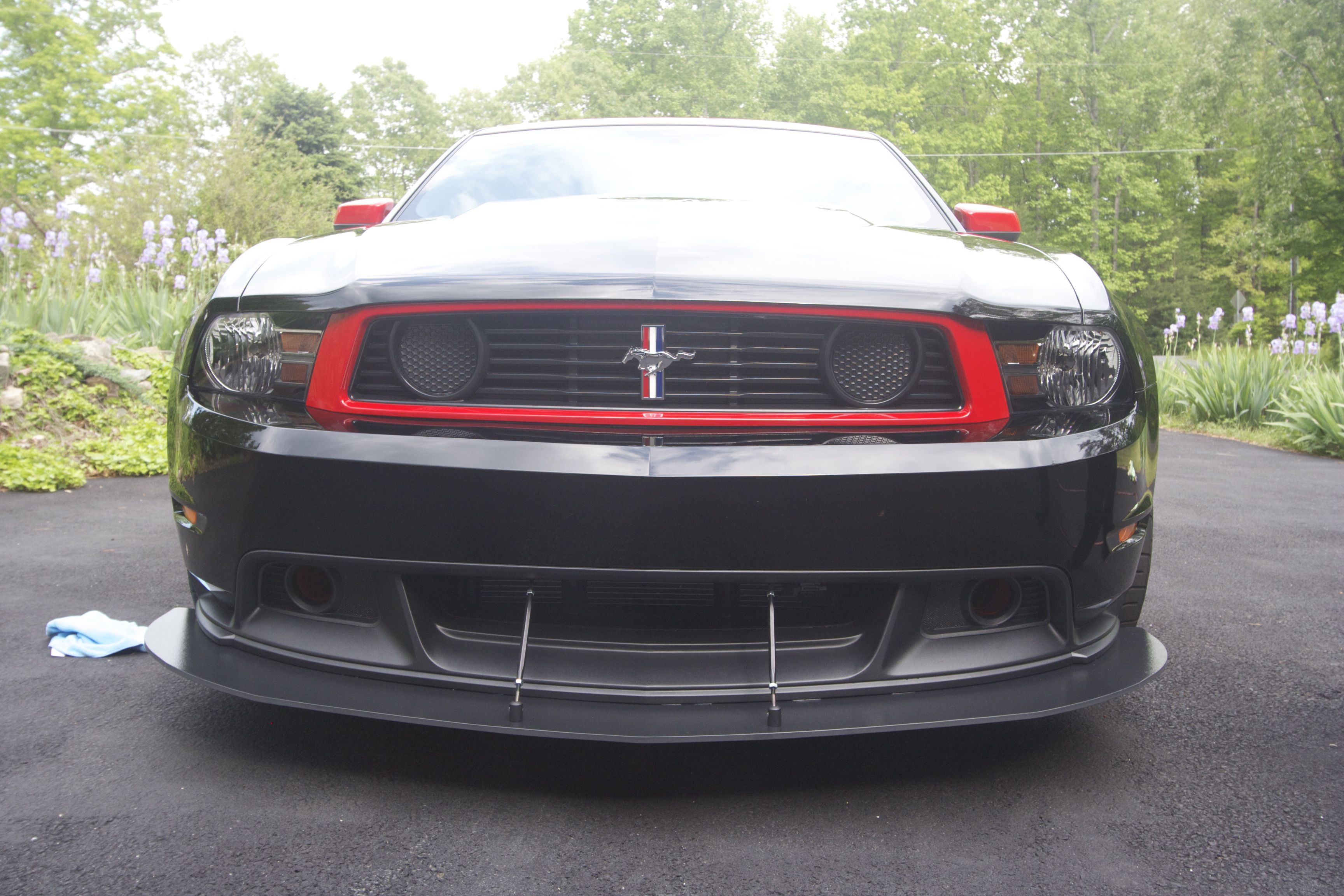

Here are some pics.
Attached Thumbnails LS Front Splitter Install Help?-img_3282.jpg   LS Front Splitter Install Help?-img_3283.jpg   LS Front Splitter Install Help?-img_3284.jpg   LS Front Splitter Install Help?-img_3285.jpg   LS Front Splitter Install Help?-img_3286.jpg
LS Front Splitter Install Help?-img_3288.jpg   LS Front Splitter Install Help?-img_3289.jpg   LS Front Splitter Install Help?-img_3309.jpg

Originally Posted by jerkstore
No issues with driveways or clearance. I drove about 30 miles mixed hiway and city traffic. My garage has a lip, so I have to pull in head first, but it works. I am used to being wary of danger zones since my Cobra is even lower than the Boss. There is just some places I don't go.
Here are some pics.
Dan
Great post looks like plenty of clearance
Thank you
