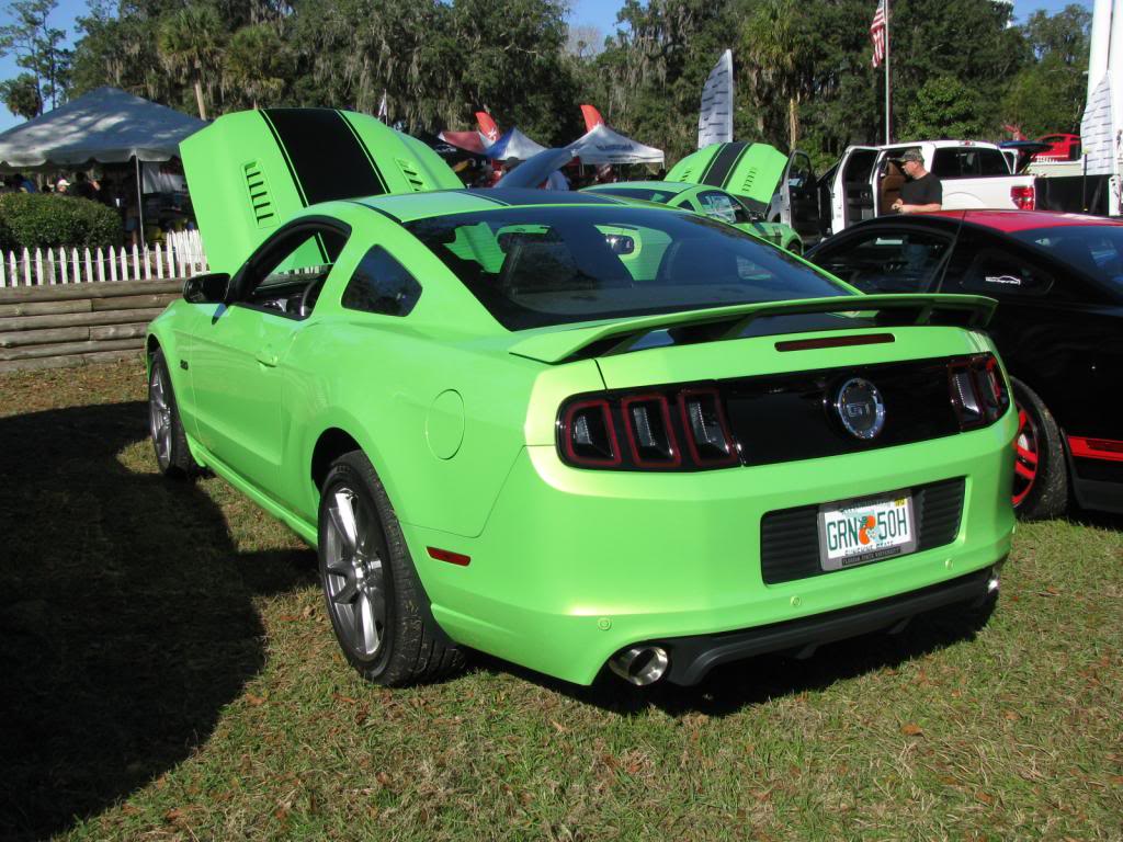

I have Magnaflow Street Series Axle-backs (part# 15151),with open side pipes (no restrictor plates). Nice and deep sounding, with very little drone, if any. IMO, they're perfect!
