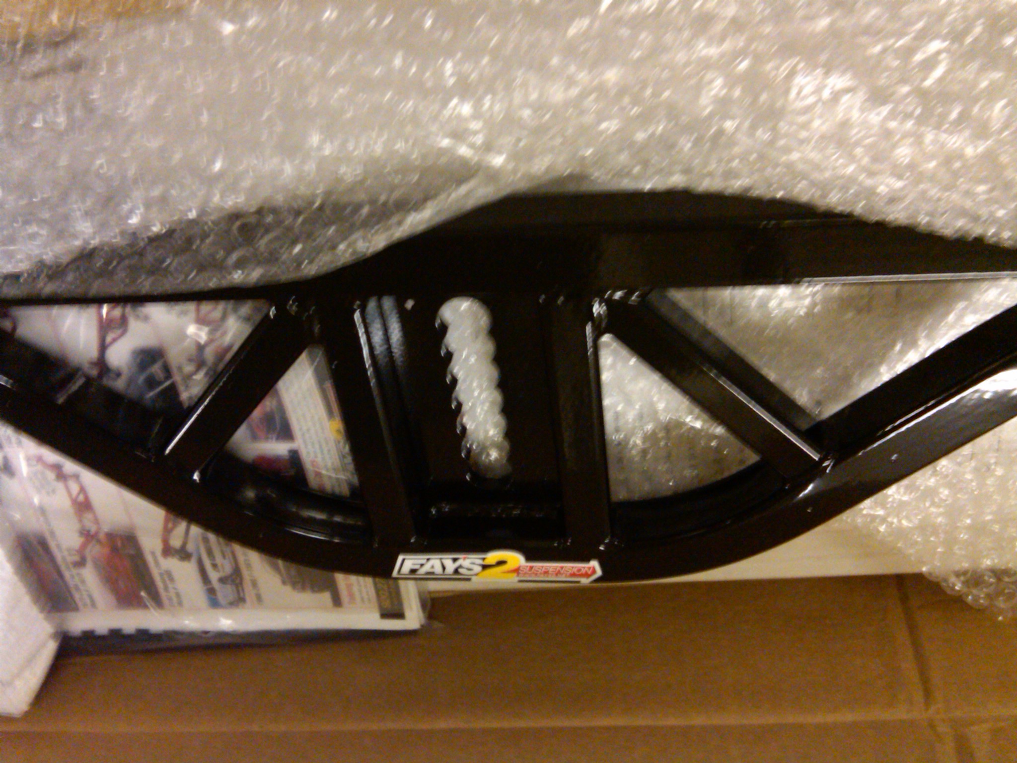

I got a call from my shipping department that a box showed up My Watts Link is ready for install. Now I just need the car!
Attached Thumbnails First mod is here!  Wish the car was!-img00021-20101229-1513.jpg

C9, are you going to track the car before installing the Watts link so you can get a comparison before adding it? Do you run one on your GT500 and if so how did installing it impact your lap times? How about overall handling improvements?

All good questions. I'll answer best as I can.
As far as a Watts link on my GT500, yes I have one. From a handling stanpoint it really helped plant the rear end during corner exit. I would liken the feeling before to the feeling you get on a waterbed. Things just kind of squish around underneath you from the rear of the car. That feeling went away after installing the Watts link. Now, the issue is I made several suspension changes when I installed the Watts link :
Before:
FRPP Handling Pack with adj Tokicos and lowering springs.
BMR adj UCA
Steeda LCAs and relo brackets
After:
Koni adj coilovers
Torque Arm
Adj LCAs and relo brackets
Watts Link
So some will argue the torque arm helps plant the rear end while others say it's the Watts link. I probably lowered the car slightly with the adj coilovers, but you can only drop so much in the rear before starting to hit the bump stops all the time, so I'm not sure how much and I didn't measure before/after.
As far as lap times. Well I only ran the same track before/after susp changes early in 2009 versus late in 2010. I ran several other tracks in between but they were new tracks to me so I didn't have lap time comparisons. I also put on an interchangable upper pulley (3" vs. 2.6") for use on the road course. This dropped my rwhp/rwtq from 640/625 to 575/545 on track. I was having overheating issues with the smaller pulley when ambient temps were over 80 degrees. Before the suspension change and with higher hp/tq my best lap time at that track was 1:46:97. After changing the suspension and reducing hp/tq my best lap time was 1:44:10.
As far as whether I'll run the Boss without the Watts link, I don't know. I'm impatient so it will be interesting to see. Since it's just a bolt-on, changing it should be relatively easy. I probably should wait, but the first track day isn't until the first week of April, so I have a lot of time to think about it.

I will be curious to see the interplay between the adjustable rear shocks, the larger rear anti-roll bar, and the larger tires in stock configuration with the Panhard set-up vs. a Watts linkage.
Any thoughts as to how the Watts will "reduce the squishiness", given all of the other components being the same?

I guess it's hard to say. I just know the rear end felt more predictable under acceleration. One other factor with the GT500 was the ridiculous amount of torque it's putting out compared to the Boss. The stress on the rear end with the Boss N/A motor won't be as severe. That alone will reduce that pumpkin pitching around I would think. It was interesting to note in this video of the Laguna Seca that the rear end "sits" and goes pretty well in stock form. It does fishtail a fair amount but that was probably intended by the driver. http://www.youtube.com/watch?v=MjHhxARzYvY&feature=fvw
I think some of the "magic" will be in the adjustable shock settings, of course. And my statements above assumed the GT 5.0 as the starting point. I also assume that the R-compound tires on the LS help quite a bit.

No doubt you're right about that. I really wish I wasn't so skeptical of how the Boss will handle under severe track conditions, but it's just that having transformed my GT500 I know how lacking the stock setup was from Ford. The Boss having adjustable dampers stiffer springs and bigger sway bar out of the box will be a big improvement over the 07 GT500s. Time will tell whether they'll be "good enough" or if upgrades to shocks, springs, LCAs and UCA will be desired. A lot of this becomes subjective as everyone has different expectations and will drive differently. Some people will track their cars on a road course while others will autox. Some will be only street driven. All those variables coupled with how aggressively each owner chooses to participate in those venues all impact perception of performance.
