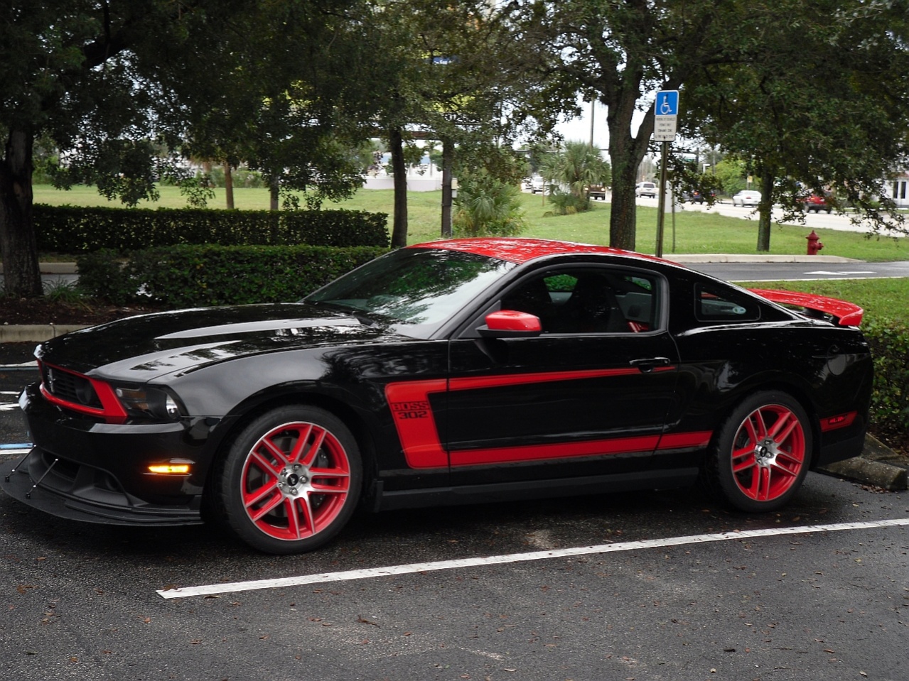

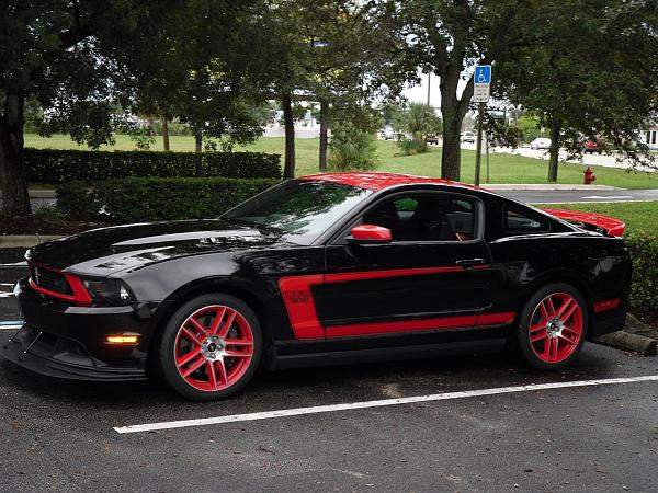

The front will stay the same height. The rear will come down about an inch so the car will be more level.
Attached Thumbnails anyone know of aftermarket lowering springs...?-boss-8241-springs.jpg
