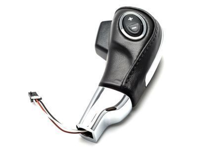

After working through my steering wheel audio control issues it's now time to address my sport shift issue.
Mind you, I have yet to actually drive this vehicle (2013 V6 Base) but I would still think that by dropping the transmission in Sport mode, even sitting still, I should get a readout somewhere that I'm manually shifting the gears. I get nothing. Does the gear selector on the base model show up on the center of the display like my 2014 F150 FX4??
I understand that these switches can be a bit problematic and might need cleaning, but with my incompatibility issue with my ACM I'm kind of leaning that way.
Does anyone have any experience with issues with these?
Thank you.

After Learning About The Corrupt Programing on The ACM The Sport Shifter / Select Shift Can Be Suspect as Well. The PCM Controls The Sport Shifter as Per Diag. The **** itself Could Be Bad But With Two Wires it Can Be tested Easy. I Am Providing Shop Manual PDf on Select Shift as Well as Link To Shift ****. Should Get You Rolling and Hopefully Driving Soon!
Just in Case You Need To Get a ****!
Parts Giant Shift ****!
I also Checked on Ebay And The Parts Giant Price is The Going Rate For Discounted ***** at The Moment. Seems To Be Pretty Popular on Ebay. Wonder Why?? Quirk Shows To Have Sold 180 *****!
https://www.fordpartsgiant.com/parts...tra2=&filter=()
DR3Z-7213-BA
Quirk Parts
https://www.ebay.com/itm/19168854339...mis&media=COPY
Some PDF'S are Not Needed For Your Issue But I Though Others Working in general Area May Benefit!
LMK if You Need Anymore Pdf's
KC

I was able to remove the shifter **** from the vehicle and test it separately. Switch works as it should.
Confirmed that the connector was plugged in during reinstall.
Switch still inop.
Couple questions for the group:
Does the vehicle need to be moving to use the selector switch on the shifter ****?
Is the vehicle supposed to show an "S" on the instrument cluster when the vehicle is placed in Sport mode, even when standing still?
Does the Base model cluster show what gear the vehicle is in on the instrument cluster?
This vehicle is new to me, so I'm just trying to understand what I'm looking for.
Thank you.

Sport shift fixed
Well, again I needed to reflash my cluster. The Sport shift may have actually been working but there would be nothing showing on the cluster. After a reflash to As Built everything seems to be right, but it'll be a while before the car leaves the garage to test it. I have to admit the new version of Forscan with the return to As Built feature is pretty handy.
Hope this helps someone else.
