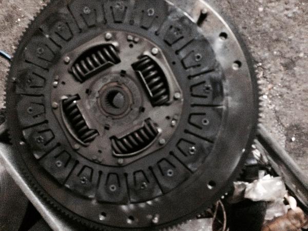

Well here was the culprit, clutch worn out, down to the metal my mechanic threw out the old Throwout Bearing/Slave Cylinder so no pics of that. I went with the Exedy Mach 600 Stage 4 Clutch, I only drove it about 5miles from the shop to my house, the car feels great, it's just going to take some getting use to the softer clutch (I must've stalled 4 times) Thanks to everyone in this thread for their recommendations and insight, this is why I love this forum.
