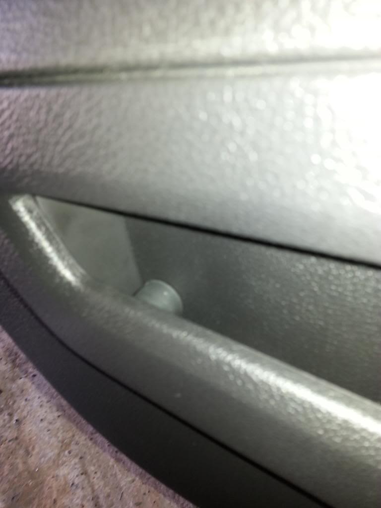

I installed pioneer front speakers in my 2011 GT some time ago
https://themustangsource.com/f804/an...86268/index11/
and I have been very happy with the sound but have been annoyed by a 'rattle' coming from the stock door woofer. This has been getting gradually worse and was so bad I thought the woofer in the drivers door was broken.
So angrily I decided it had to be checked. Taking the door trim off I inspected the speakers and woofers and found them all to be intact. Running the shaker with the door trim off no discernible rattle. Increasing to full volume I noticed the 'sound duct' running along the length of the lower door to the woofer was rattling and was producing the sound which had made me think the speaker was knackered. In act the whole tube was vibrating and making the door tray vibrate.
I fitted self adhesive pads to the 'tube' so it made contact against the plastic inner door trim (the translucent white stuff). I re-secured the door trim as tightly as I could.
Should have taken pictures but didn't.
I have further refined this by gluing in sections of plastic tubing in the pocket at the front and rear of the pocket to hold the celebration of plastic Ford have used rigid.
No more rattles - phew.
Anyway the long and short is that if you suspect your speakers membranes have broken check first before buying new.
It might just be all that plastic vibrating!

Yup my 2014 Has the same issue it just appears to be the small cubby hole at the bottom of the door if you grab the plastic all the rattle goes away. My simple fix will be to just wedge some kind of rubber to prevent It from vibrating and causing the rattle which is very annoying even at lower volumes!

I ended up doing the tube that Mykap did but only on the passenger door. I'm still having issues with the window switch panel vibrating. The stuff I used to dampen the sound isn't holding up to the heat so I need to find something else to stuff in there.
