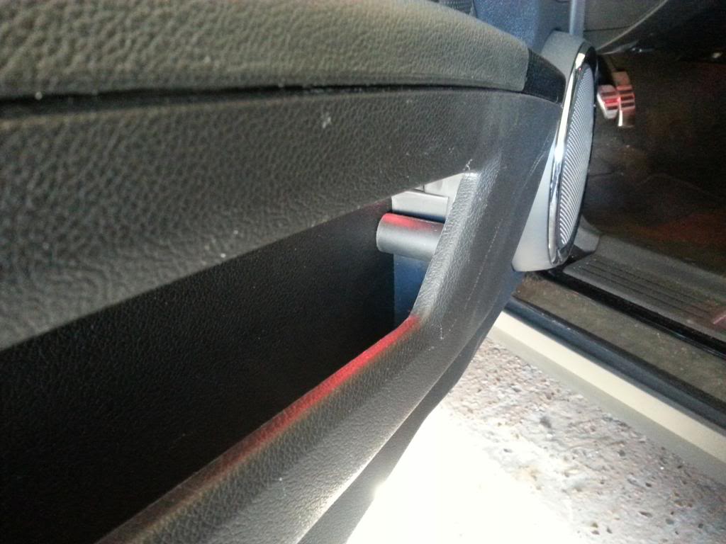

Sorry for delay- just done a mini world tour for work... Kazakhstan, Spain, Azerbijan now back in UK.
Solved mine by gluing in Plastic pipe as shown...
I also covered the rear of the panel with dynamat ie inside the door panel.
