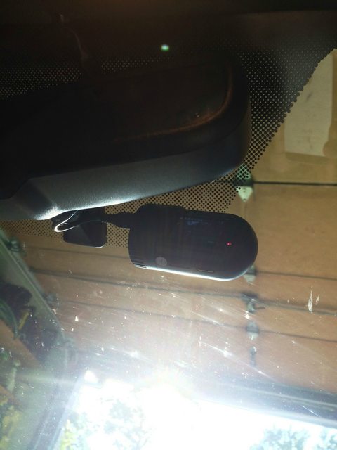

Not the fastest of projects by any means, but really happy with how it came out. I have the power cable running in the same sleeve the rearview mirror cable is in to keep it as clean as possible.

Don't mind the really really dirty windshield. Thats the result of an overnight drive from Michigan to Massachusetts via New Hampshire. BUGS EVERYWHERE.
