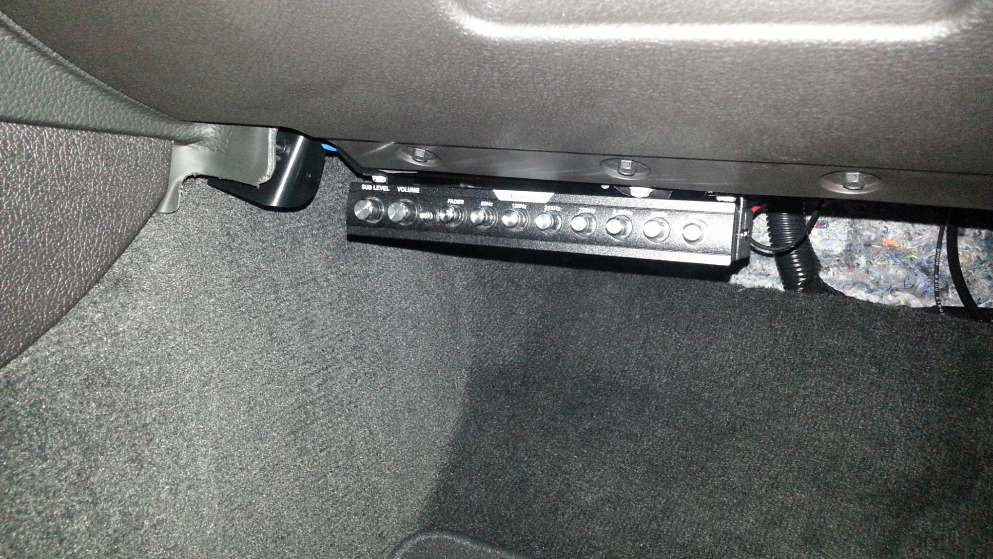

I put a Clarion EQ inline after the PAC and before the amp. Made a big difference. This is where I mounted it and still be able to have access to it. Adding rear AMP to Shaker 500 on 14 GT-20140813_142714.jpg

I put a Clarion EQ inline after the PAC and before the amp. Made a big difference. This is where I mounted it and still be able to have access to it. Attachment 163214
Trying to find a good spot for the EQ like that in the car is difficult. I had one in my old car and I had to modify the dash kit for the radio to hold it.
