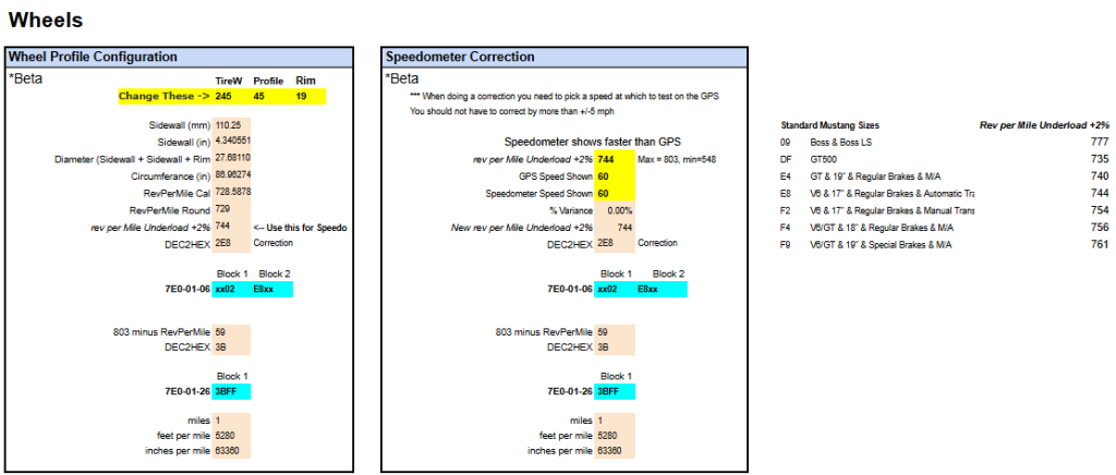

I have added a calculator for correcting the tire size that is installed on the car if you change your tires. This is currently in Beta but appears to be solid for the cars
