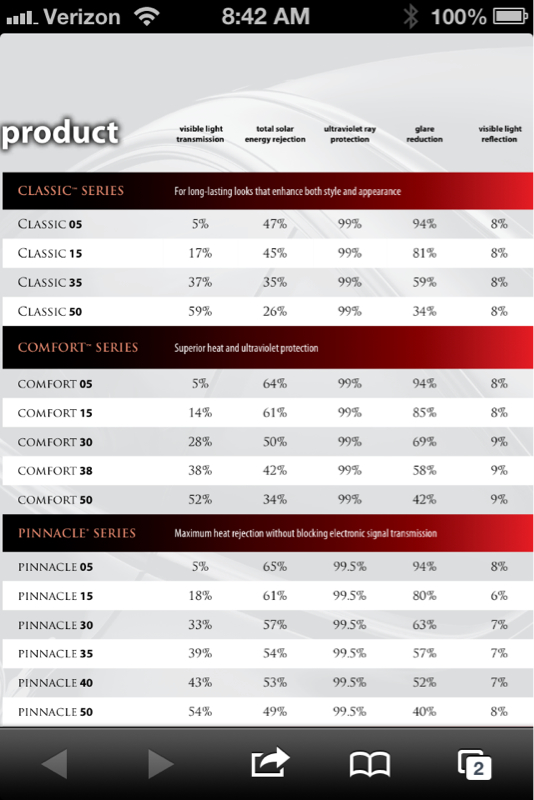

Here's a chart that shows the performance of the different series of FormulaOne tint. As you see the darker you go, the more heat rejection you get. You also won't be able to see out or in as well, especially if you have a Nav unit lighting up the cabin. If you live in the city where the streets are lit, you will be able to see better at night with a darker tint. I live in a rural area and if I had 20, I wouldn't be able to see anything at night.

So you guys are saying I should get 30%?
Old Apr 14, 2013 | 06:49 AM
  #109
That's what I would do...I have 20% on the back 3 windows of my SN95, and I wish I did 30 all the way around.
