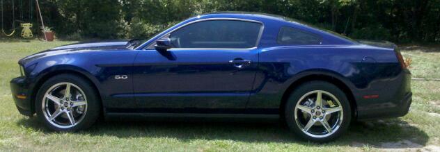

Will it work, yes.. will it be safe, no. You can pick up 18x10's at American muscle for a real good price.
