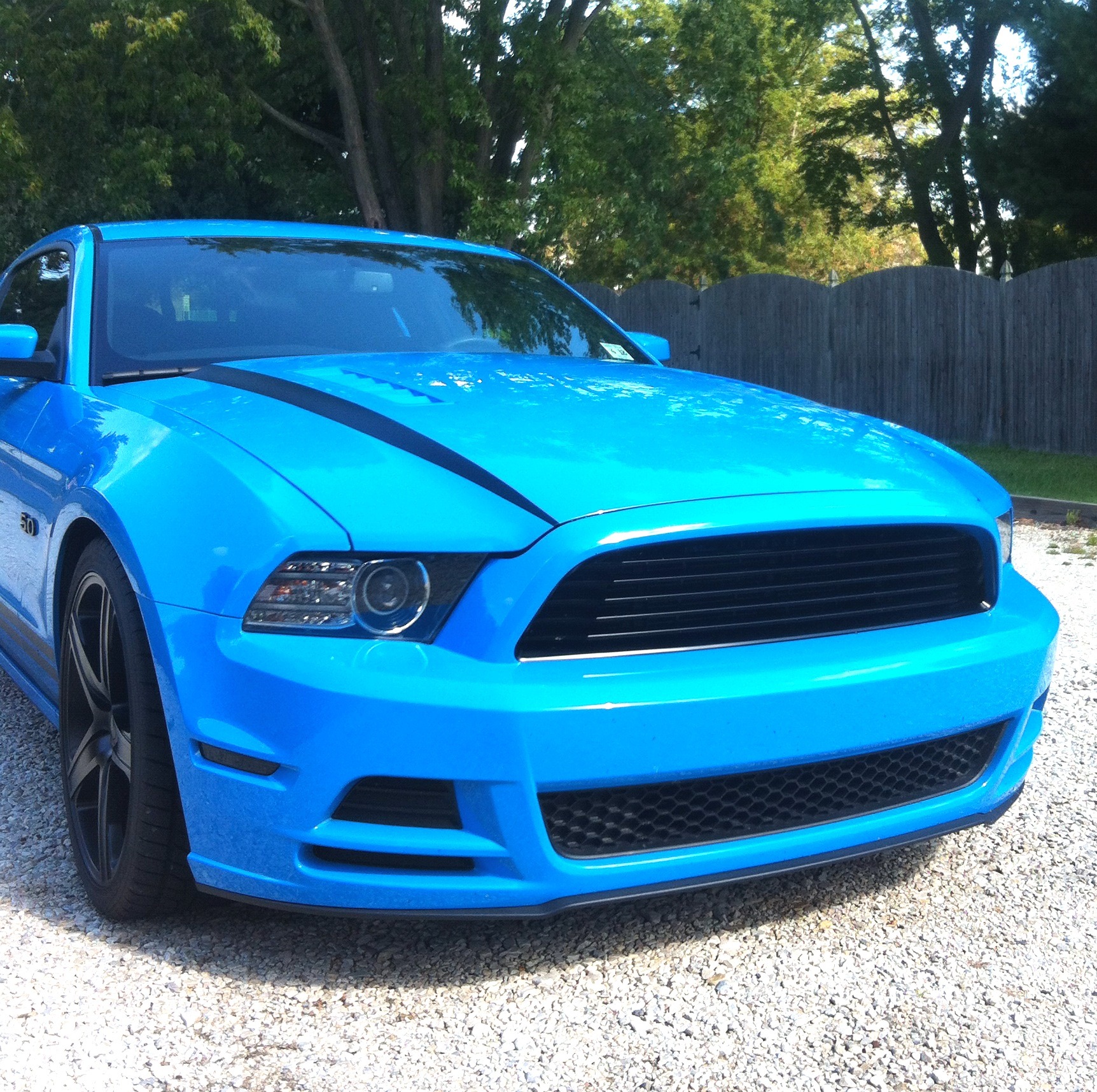

Heres a quick pic I took today, its hard to get the right lighting. I am putting on the chin spoiler tomorrow so maybe I will have better light in my garage. Still waiting on the roush lower, they said sometime before January but Im willing to wait it out.

Looks good. First time I've seen hood spears on a 13.

Looks good! Thanks for the pic
